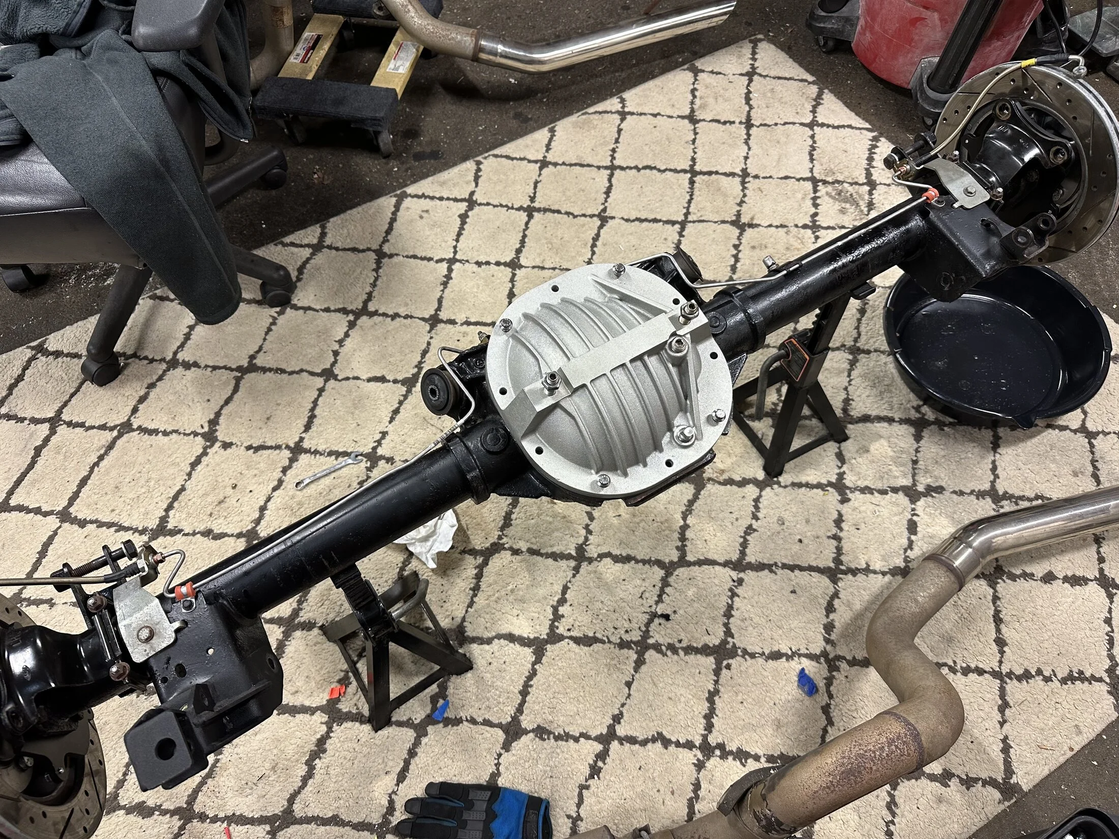

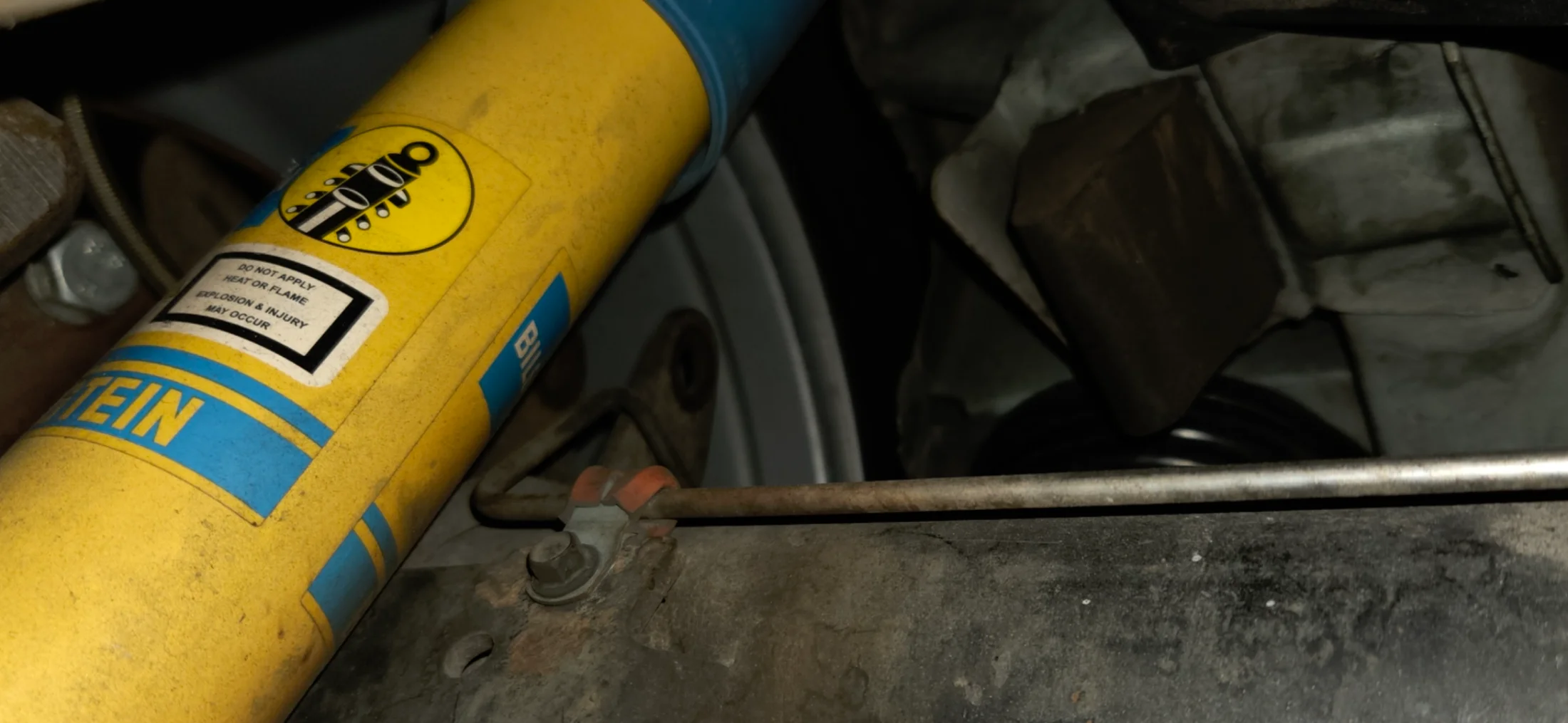

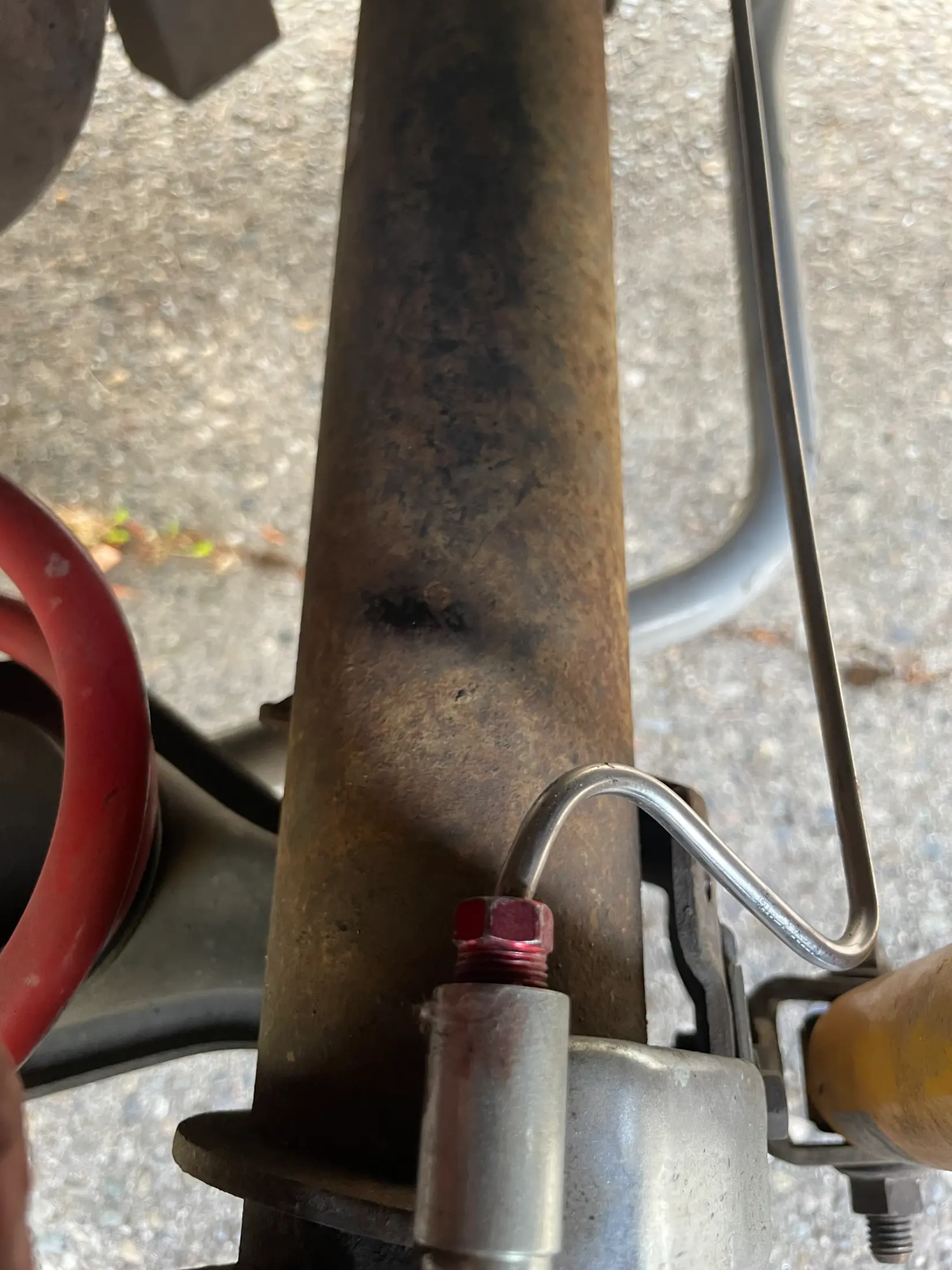

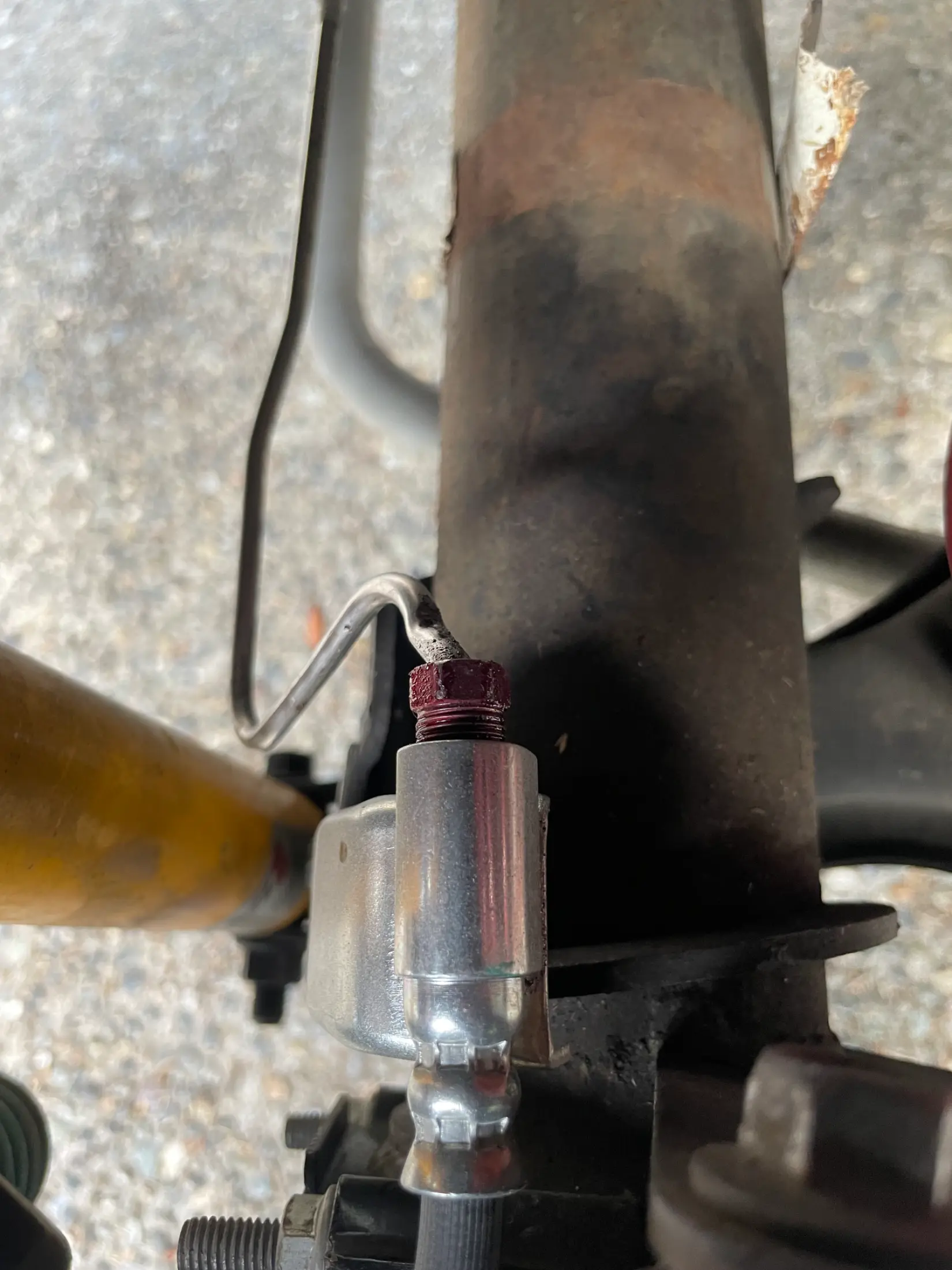

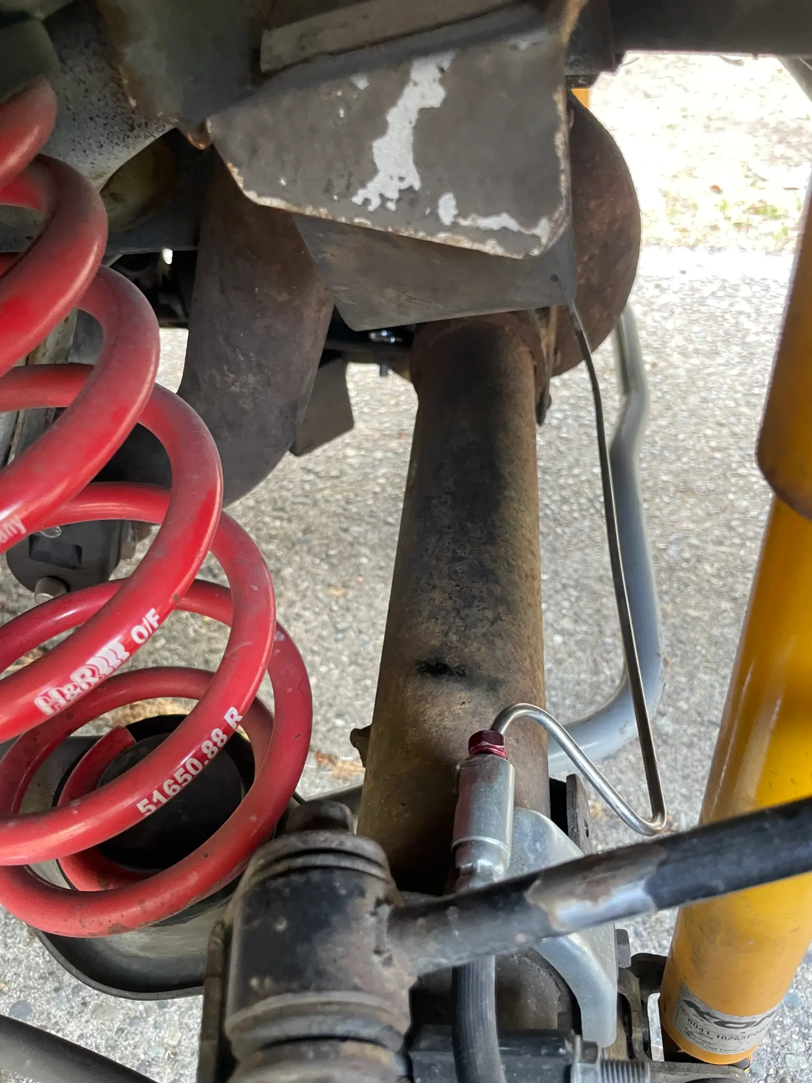

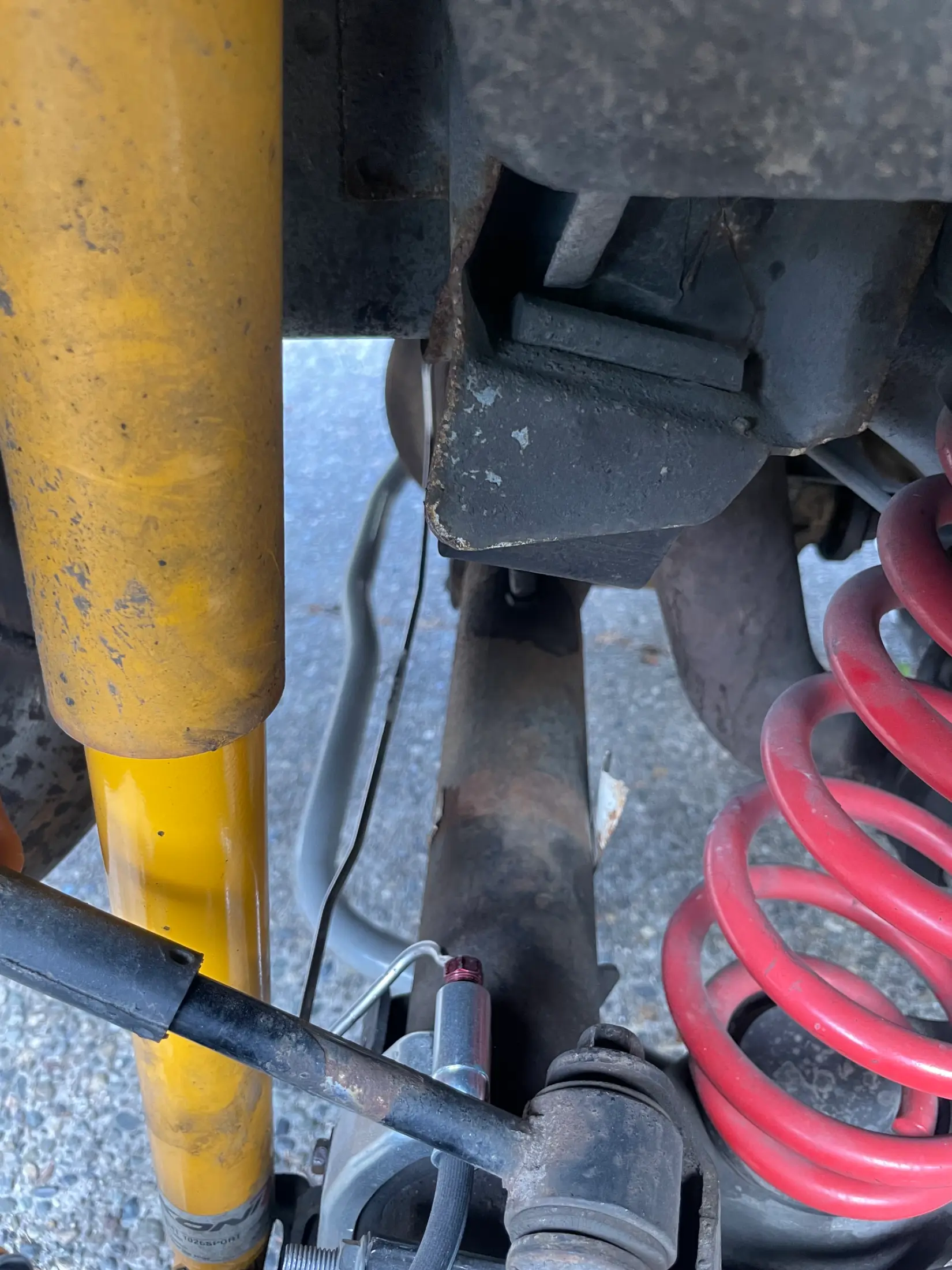

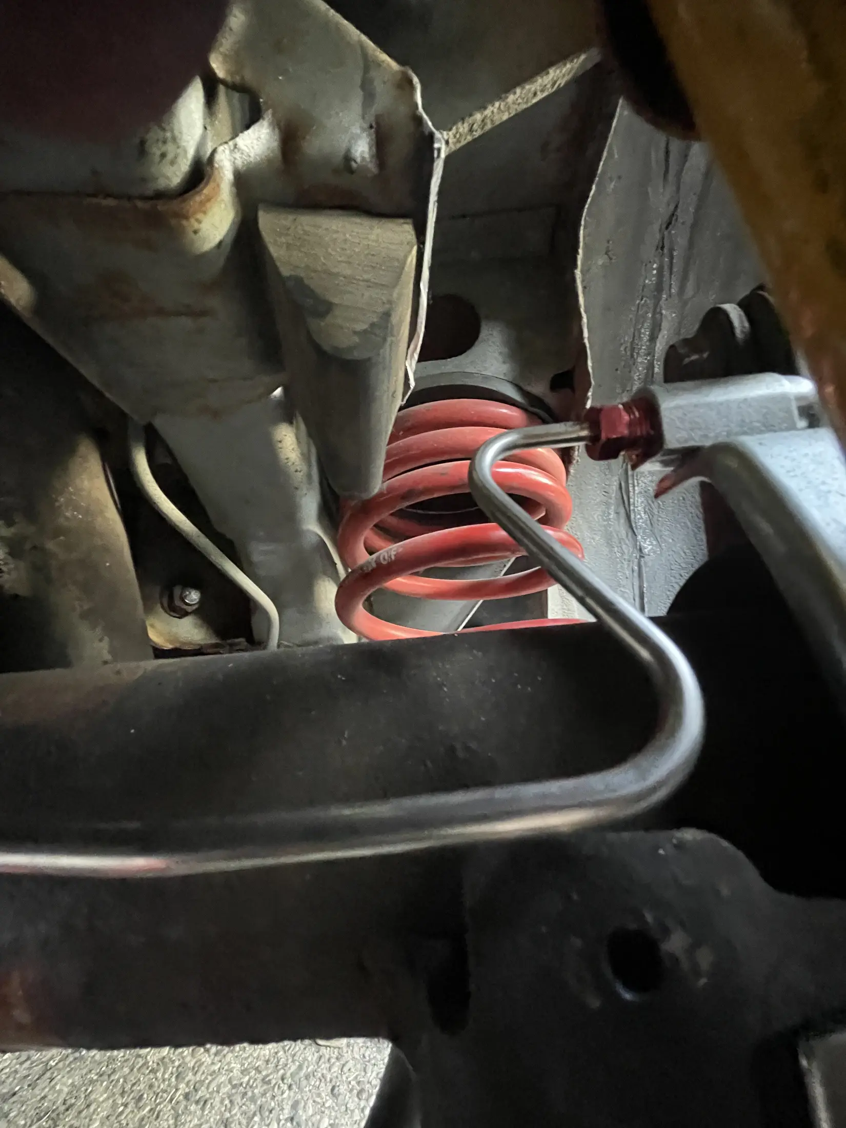

I’m running LMRs hard brake lines for disc brake conversion on my Fox and I ruptured a brake line by what looks like slamming it into the bump stop on the axle. Has anyone else experienced this? How can I fix this without removing the bump stops?

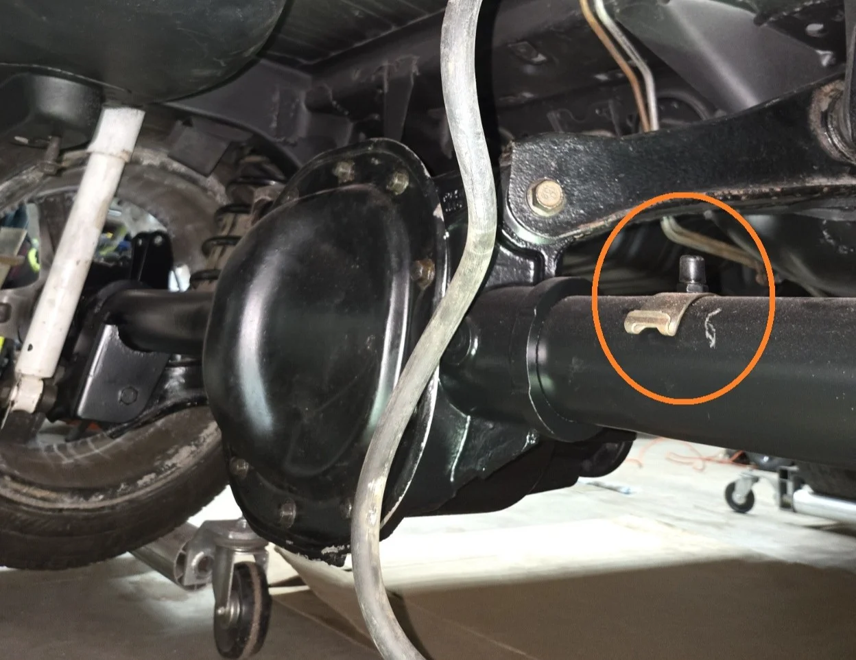

Yes, bend the brackets - more accurately twist them to change the angle slightly so the fitting and tube coming out will miss the bump stop. Also, the brake lines should be tighter up against the axle tubes. There is usually a hold down clip on each axle tube about midway along the axle tube (one mounts with the axle vent).
They were nice and tight against the axle tubes until the metal part of the bump stop bracket pushed them away from the axle.
It's weird that there is no mention of having to do these modifications on LMRs website or install video. All the parts I used were recommended for the install.
These lines were installed like this for ~3000 miles so I'm glad it happened when I was close to home! Got the brake light on the dash and I thought there was something wrong with my parking brake sensor but turns out I was losing fluid fast.

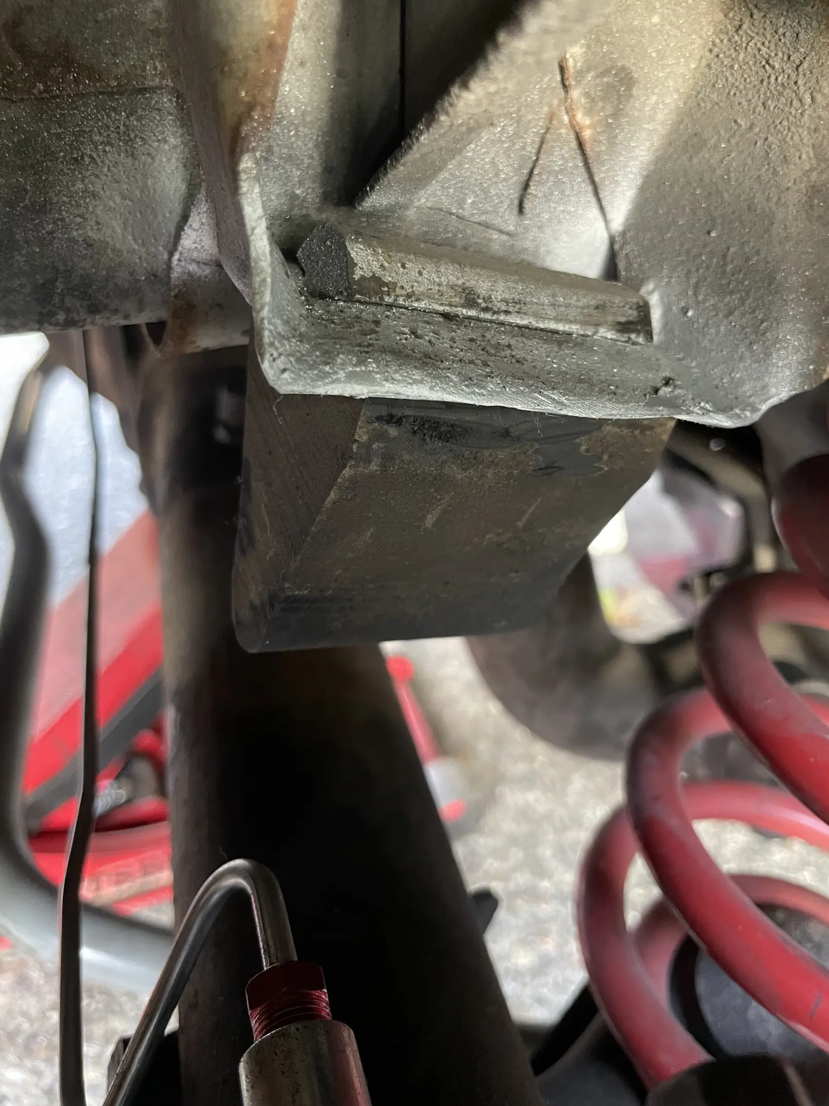

What do you guys think about just cutting off the metal part of the bump stop bracket? Seems like that piece isn't really doing anything and it's what is actually hitting the brake line.
If the dark spot on the axle tube is where the bump stop hits, you shouldn't have needed to modify the brackets. Is the axle moving side to side excessively.

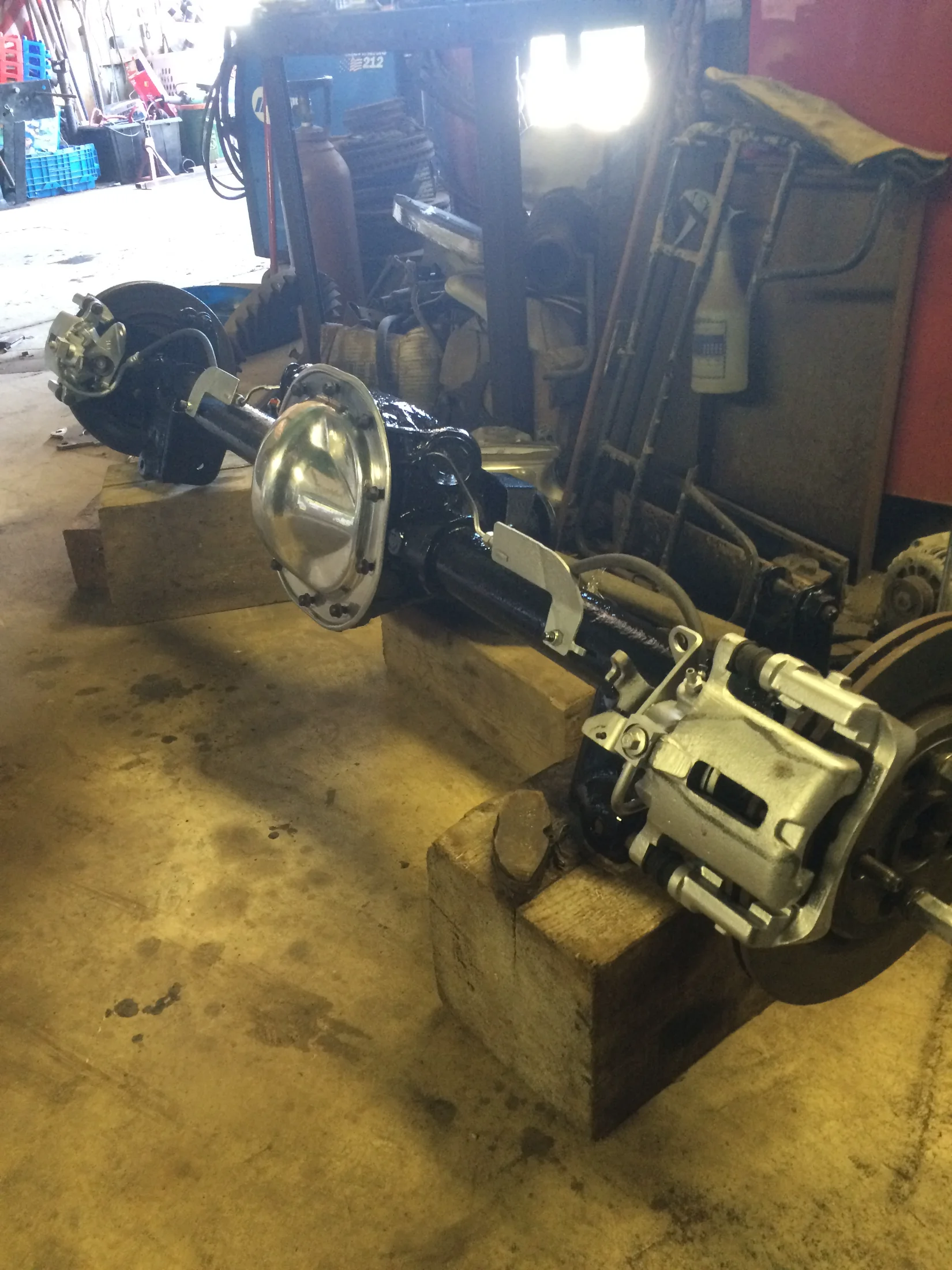

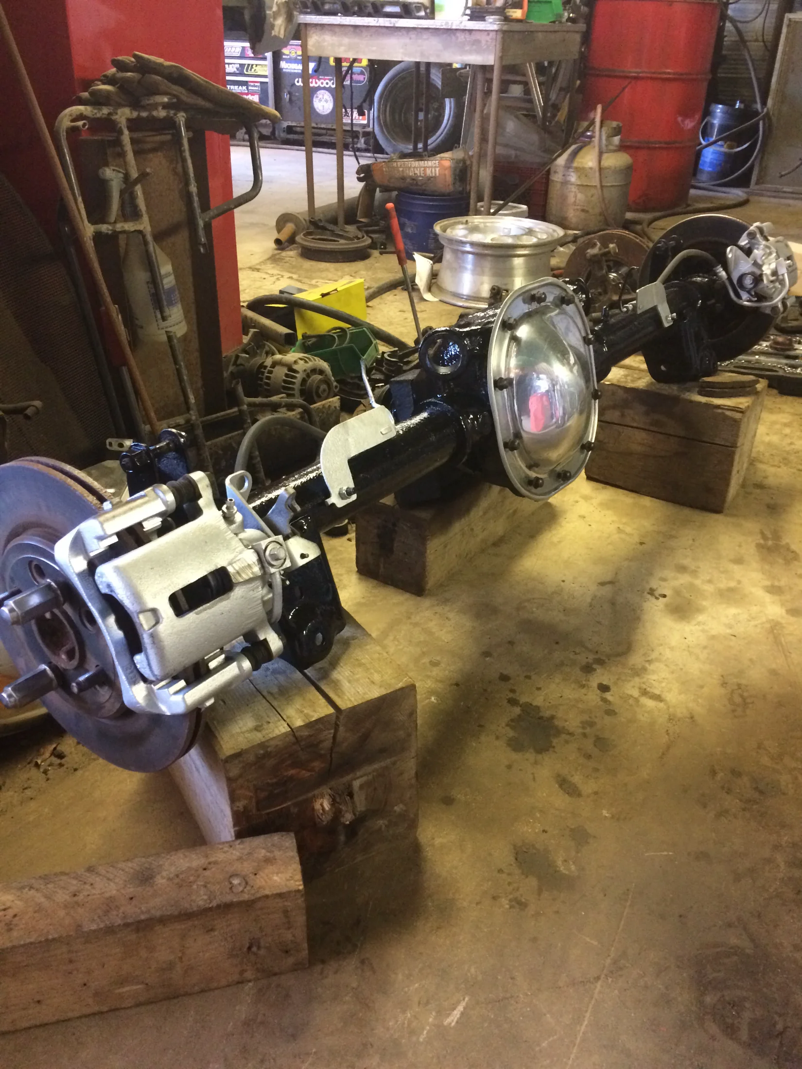

When I did my 5 wheel disc conversion I just used SN95 hoses/brackets.
The rubber part of the bump stop clears (barely), the metal part of the bracket sticks out about 1" closer to the brake line which is what sheared through my brake line. I could see witness marks on the metal.

I forgot to come back and update this thread, I ended up just cutting part of the bump stop bracket for clearance. I do plan to completely remove them at some point and go to an SN95 rear shock but this should hold me over until then. I don't have the little brackets that secure the line to the axle in the photos but I've got those on there too now.
