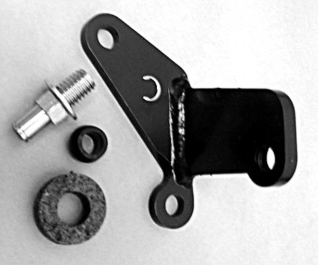

Yes, there is an adapter which works perfectly to use the stock 64-70 linkage on the 5.0.
