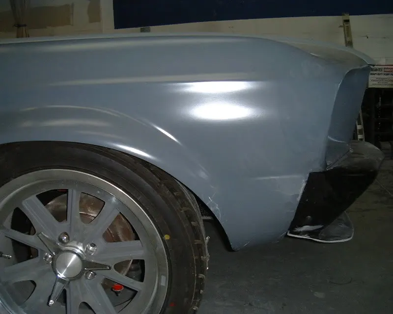

That's correct. My valance was designed to accept a stock bumper, and the round holes are for the parking lights.
However, I wanted air ducts for the front brakes. So I had the body shop cut those rectangular holes at the valance crease. Then, I fabricated a couple of fiberglass scoops that attach to the back of the rectangular holes. Also, after the body shop cut down the length of the Maier valance, they reshaped the front edge and blended the sides into the fenders.

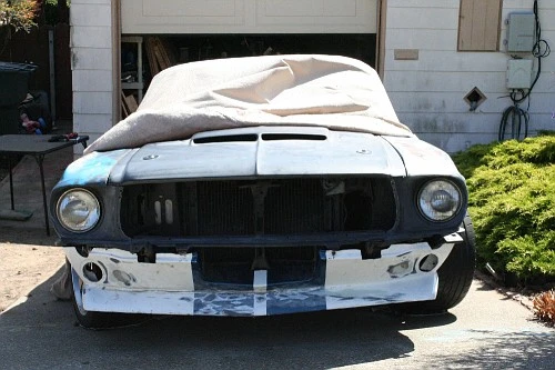

Mine had brake duct holes from the previous owner but I fiberglassed them shut.
I took that pic last week as I was trying to mock it up. Over half the bolts didn't line up so I took a pic and called it a day. Staring at it for a while I can see where the bottom of the grille is uneven which explains why the bolt holes don't line up. The driver side of the grille opening is definitely taller. This weekend hopefully I'll get to chop the spoiler like Rusty did if I don't spend all day hammering everything "straight".
