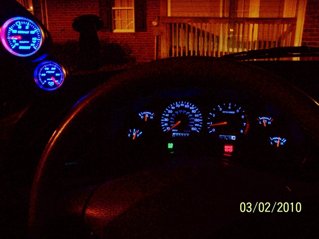

I've currently got a fuel pressure and vac/boost gauge, and I like that setup. I am, however, very seriously contemplating adding a wideband as well, just for safety sake. I do like the gauges in the pillar vs. the dash pod location. Just my opinion.
My setup:
Don't worry about what people "normally do", and don't buy a narrowband gauge. They're virtually worthless. They don't have anything resembling a linear response curve, so they're only really accurate at stoich (14.7:1), which won't tell you anything useful. Boost is more of a "bragging rights" number more than an actually useful metric in my opinion. If you want to keep tabs on things and you can only have 2 gauges, I'd get a wideband AFR gauge and either fuel or oil pressure.
