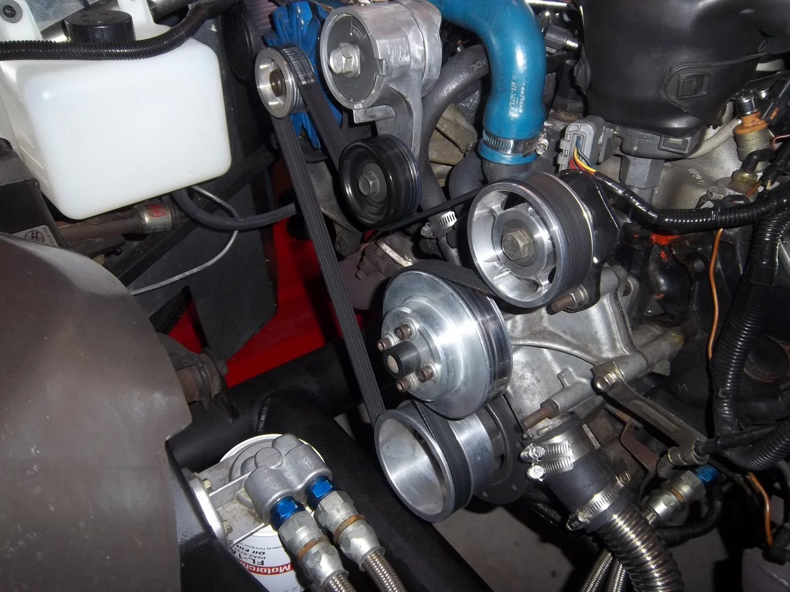

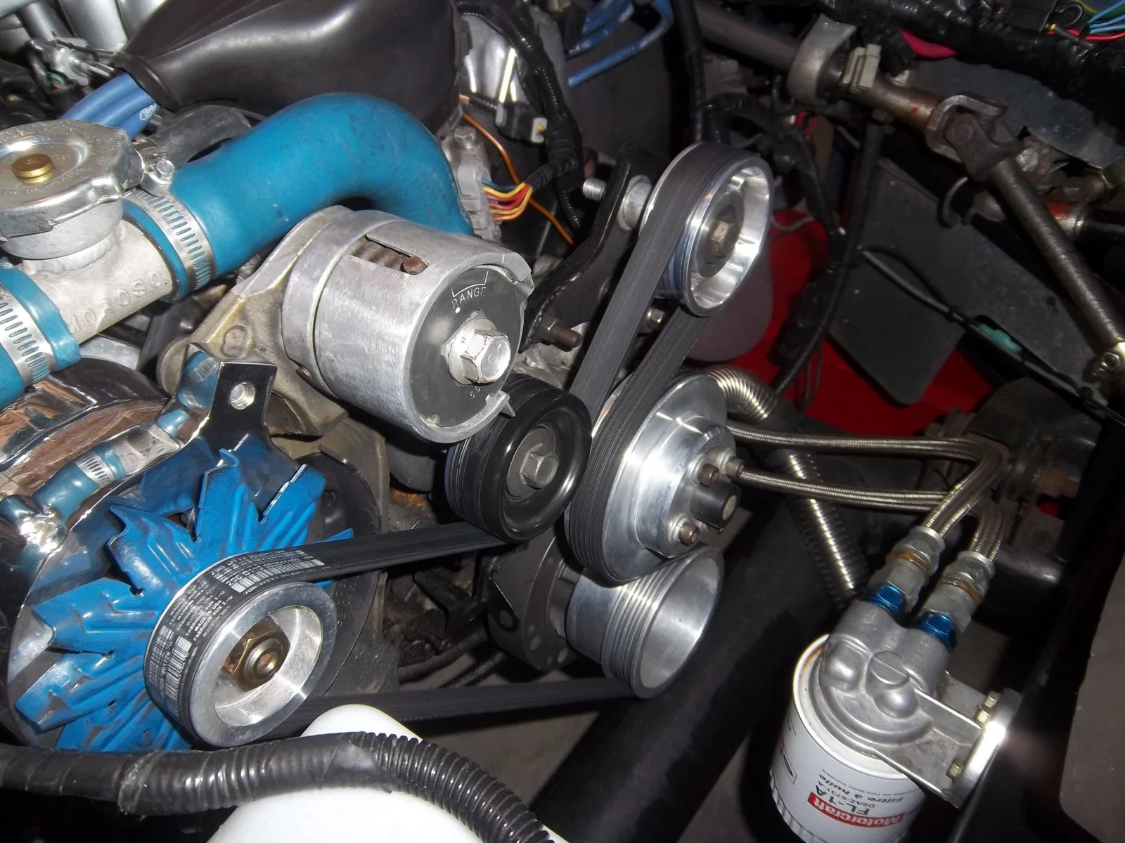

Angelnava81 said:
I’m deleting the smog pump and eventually the a/c I’m wondering what is the better route getting a shorter belt or the free spinning aluminum pulleys also any tips and advice would be greatly appreciated
Here ya go....1990 Mustang GT 5.0 302.No AC,no power steering, no smog junk Pulley here https://www.ebay.com/i/290580284103...sZ2XdRNVo3leYzH29k0d3twQS1TabAQgaAqhYEALw_wcB
