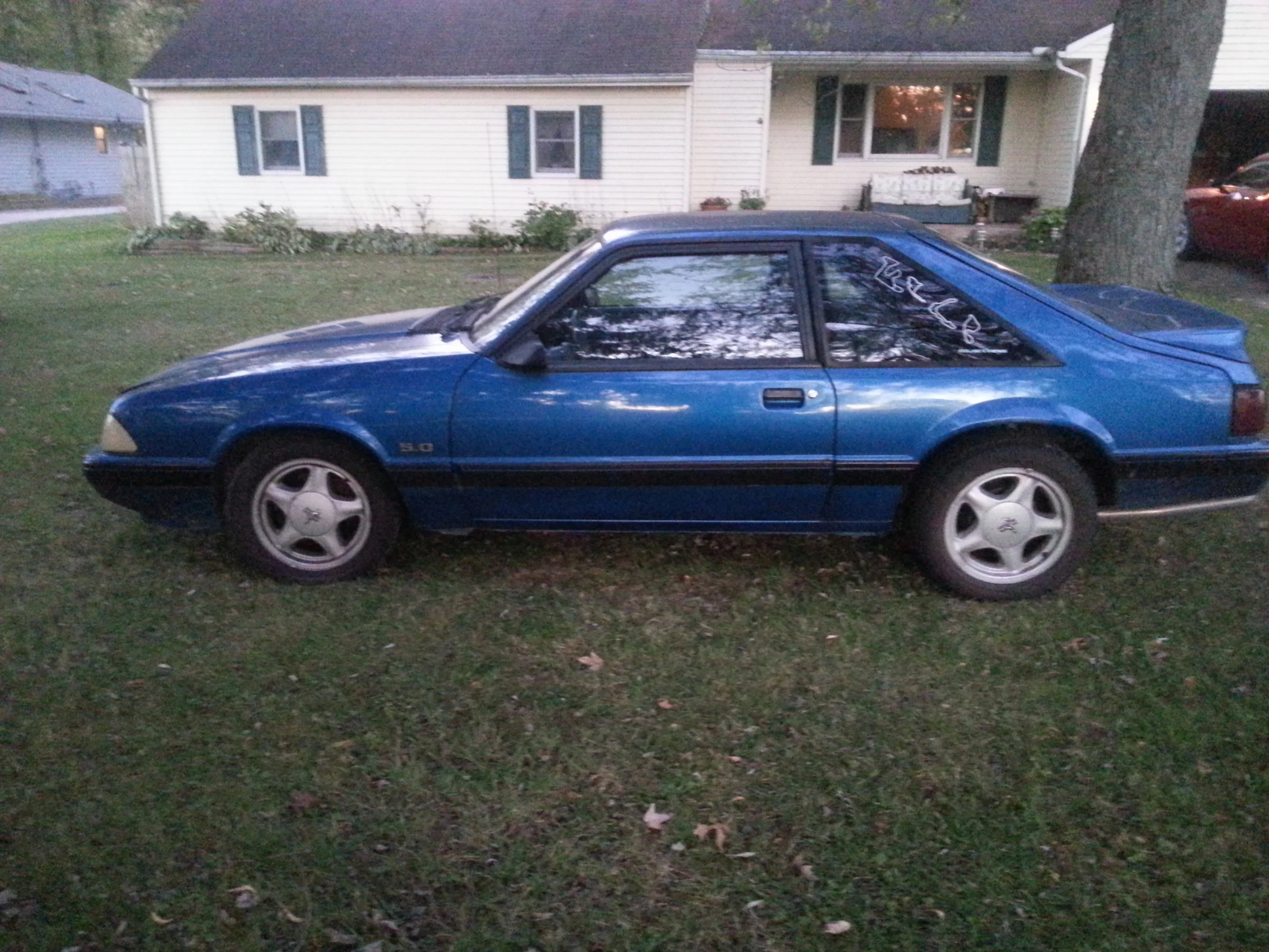

My car came with some Blue springs from Max Motorsports. It rode like a go cart and handled like one. I changed to FMS B springs for the rake and better ride for the family. It was the right choice for this car.
