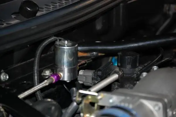

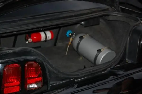

i have a zex wet kit, im almost done with the install, ive only been working on it a hour or two a week, i will be running a purge, bottle heater, and pressure gauge. heres a few pics of my install..........
pressure gauge, arming swich, bottle heater swich, and purge butttom, its where the stock CD Player was(i know its kinda dark)
purge selonoid mounted on the strut tower brace
