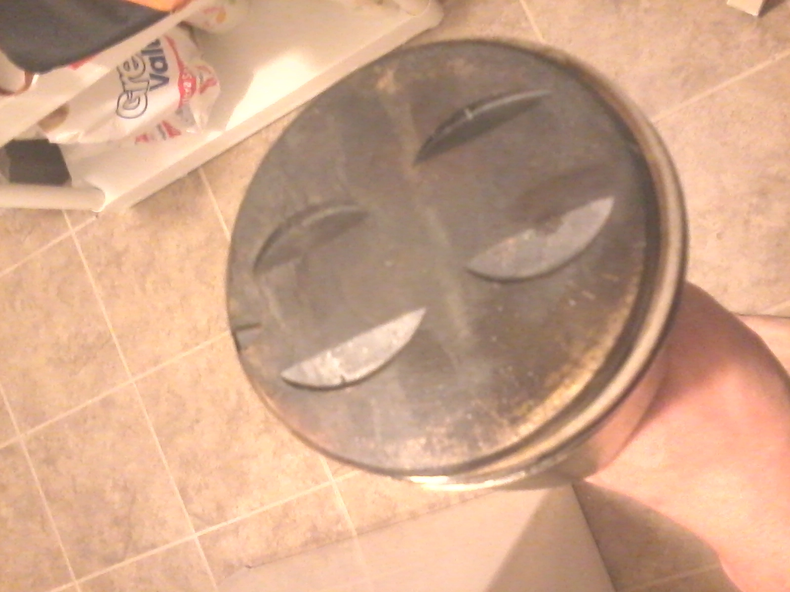

I was wondering if anyone can tell me which pistons these are and if they will work with AFR 165 heads, E303 cam, and 1.7 RRs without any issues. The block is an 86 HO with e7 heads.

They look like stock 87-93 flat tops with valve reliefs. Your setup had been done for decades at this point with no PTV issues.:nice:
