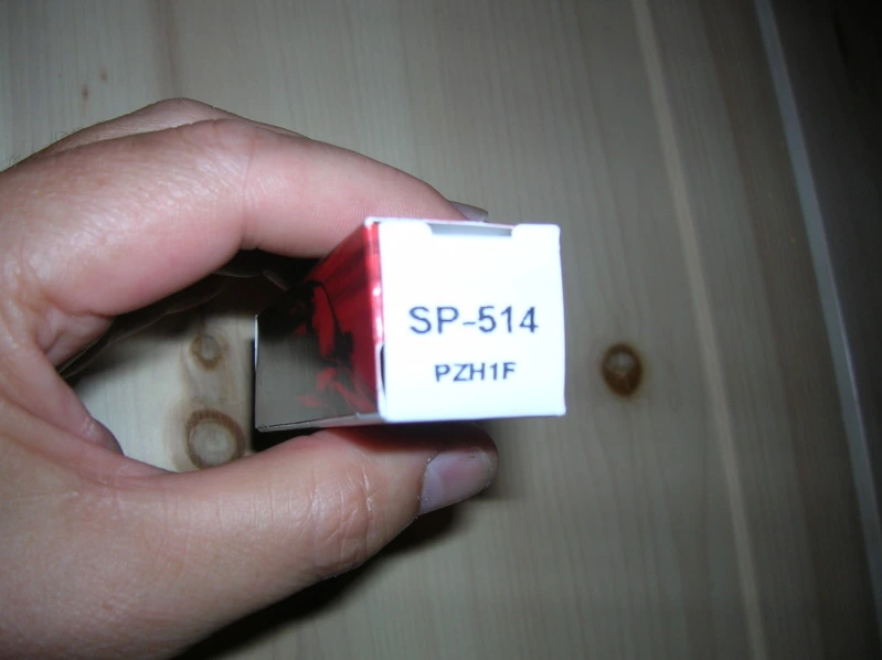

I'm trying the new Autolite's. They claim to be a 1 piece and look like a good plug. I know Autolite doesn't have the best name but i got that a really good price so i figured it was worth a shot. So far so good but I just installed them last night. I know for sure my car does idle smoother and seems a bit more responsive
