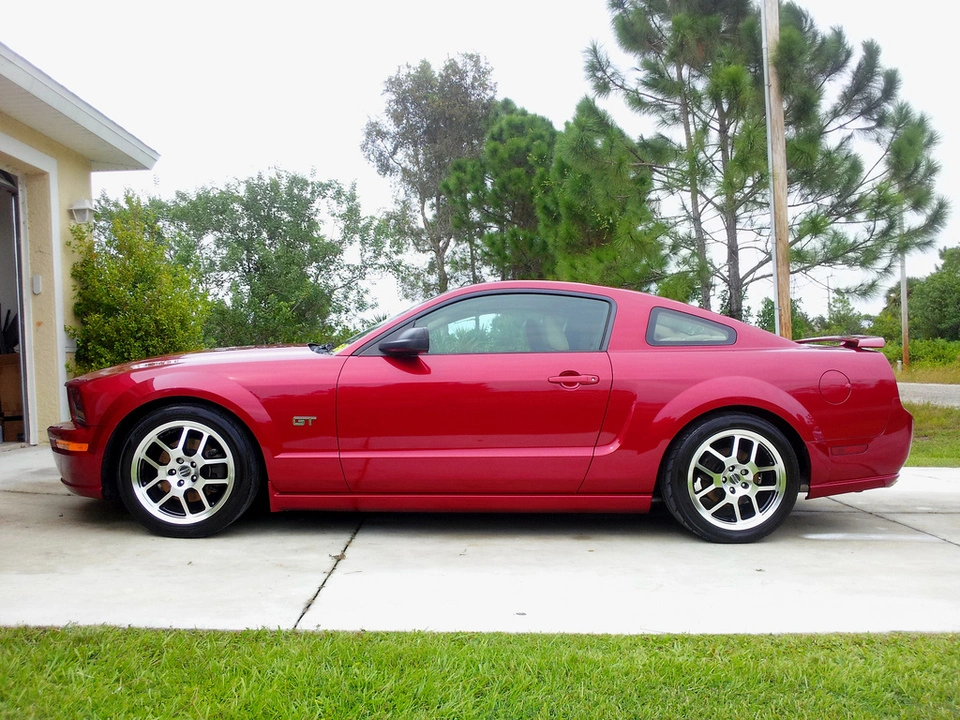

I have the UPR Pro Series springs on my 2006 GT which are actually manufactured by Eibach and they spec out identical to the Eibach Pro Kit springs. I'd call it more like a 1.5 drop.
First stage of UPR Products Suspension by sharadraldiris, on Flickr
