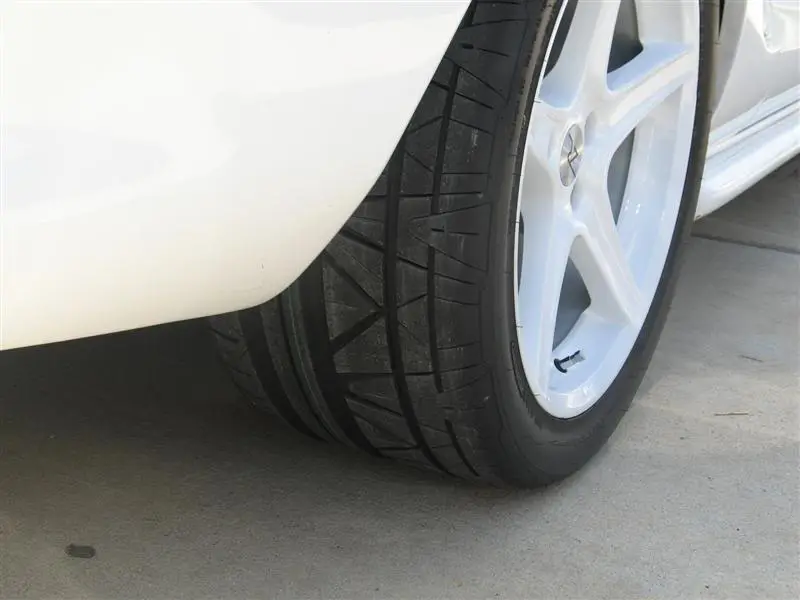

255 would be a bit narrow for 9.5'' rims, the 275's should sit flush. I have those 295's on 10'' rims and again flush
With an 11'' rim I would up to 315's for a more flush fit, sucks they don't make a 305/35 as that would be perfect.

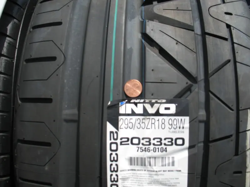

So far they have been great on wet and dry roads. I try not to find the limits of my tires on wet roads but I feel confident on wet roads no matter if it's city of highway. These tires also run very quit in all speeds I have had them in (I75 doing 95 is the highest). If they continue to perform they way they are I will buy them again with out hesitation.
BTW the water channels are a lot wider then I thought
Penny wide so they can move some water.
