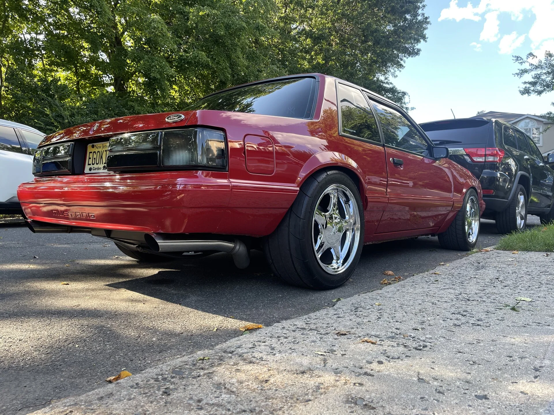

This car has 245/40 on the front and 275/35 on the rear..... Looks OK to me

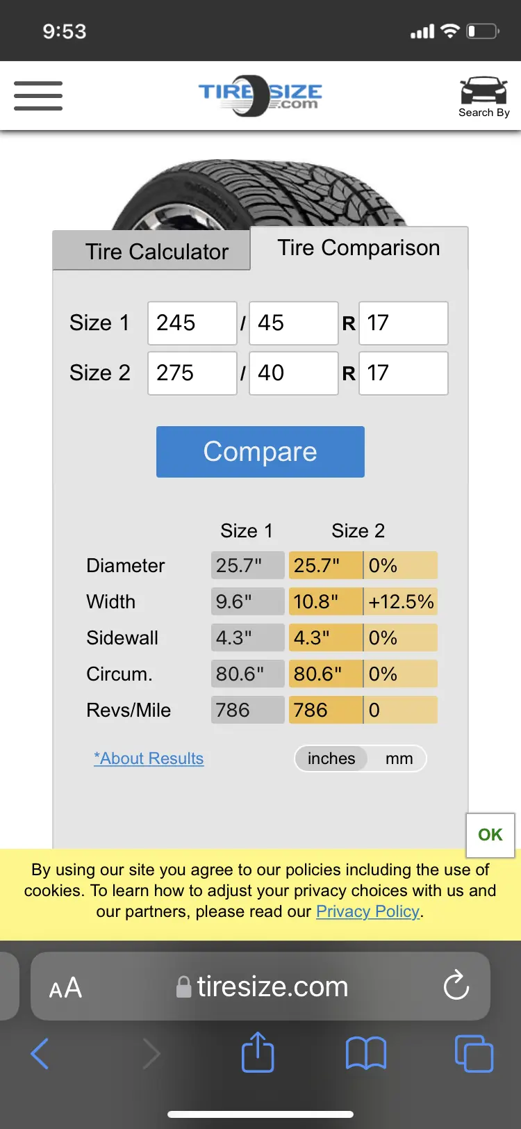

Ok so the tire also comes in a 275/40r17 and from what I’m reading a 245/45r17 and a 275/40r17 have the same length sidewall so I guess I’ll go with that. Is anyone else running this setup?

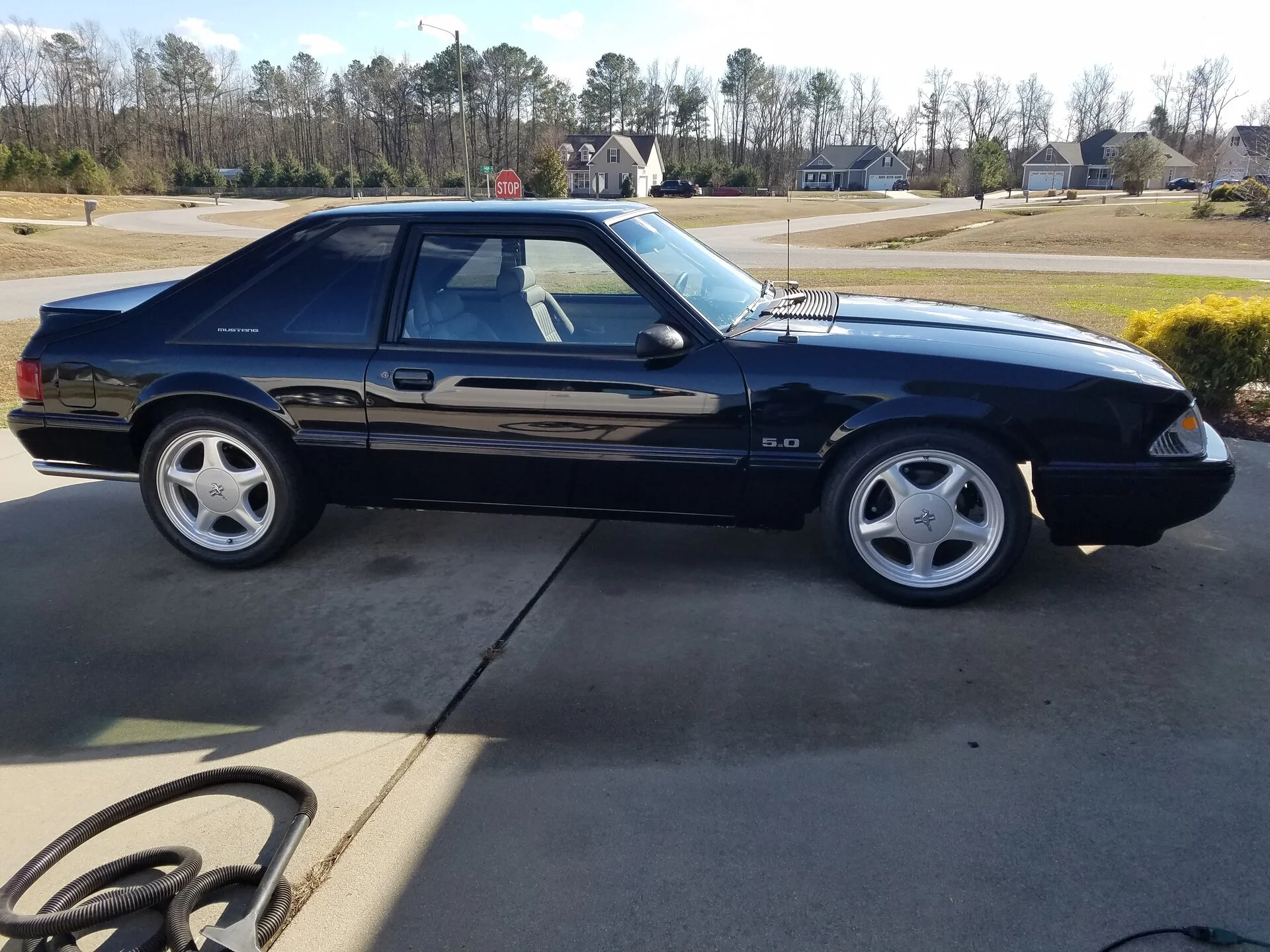

I have this same setup on 17" Pony Wheels and couldn't be happier with the way it looks and fits.

The ratio for both tires are pretty close (18.3 for the 245s vs. 18.18 for the 275s). Personally, unless you have modified the front or, rear suspension geometry, I wouldn’t mix tire sizes. Engineers much smarter than you or, I designed the car to have balance which includes four of the same shoes all around. Happy Motoring.

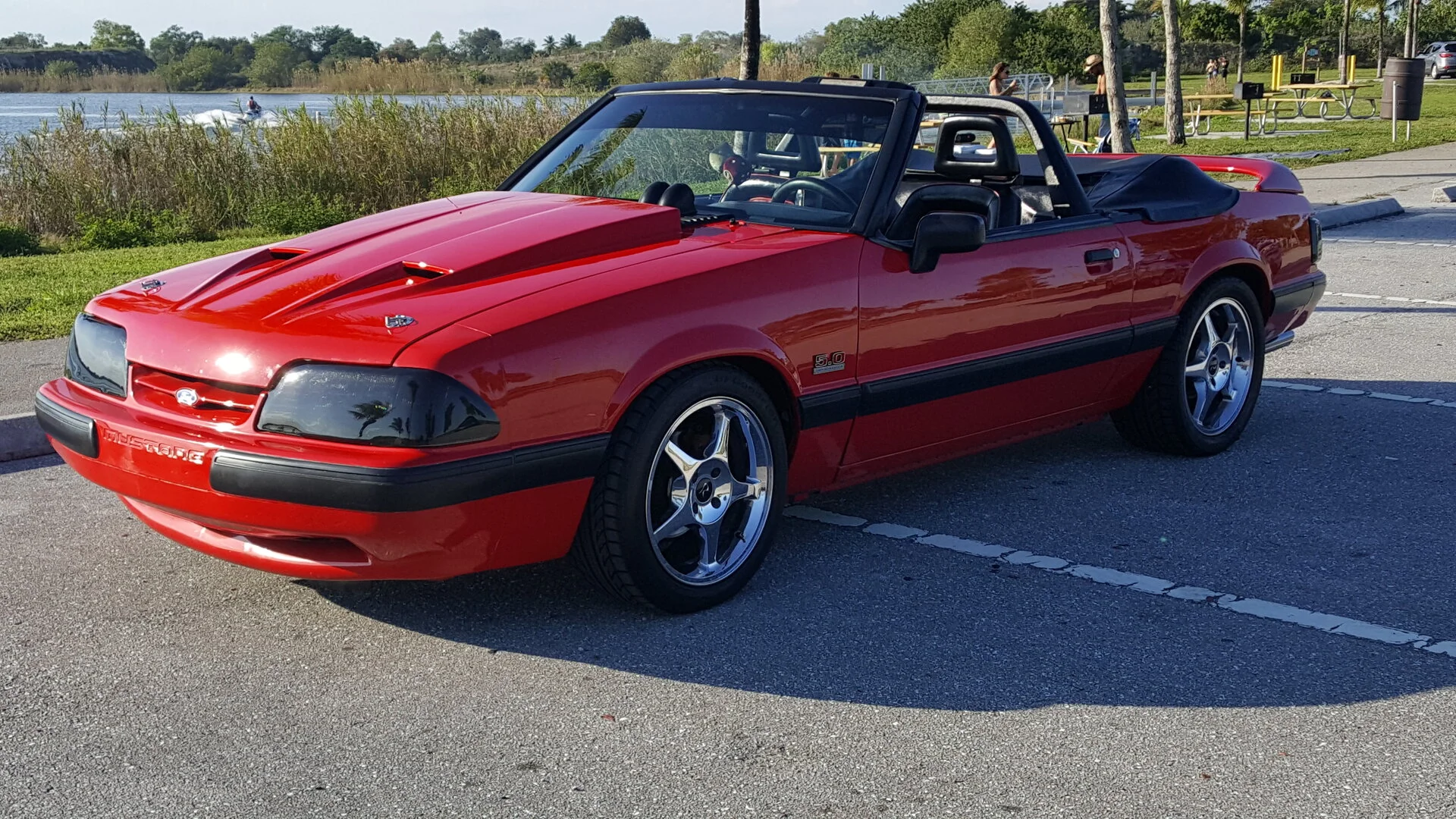

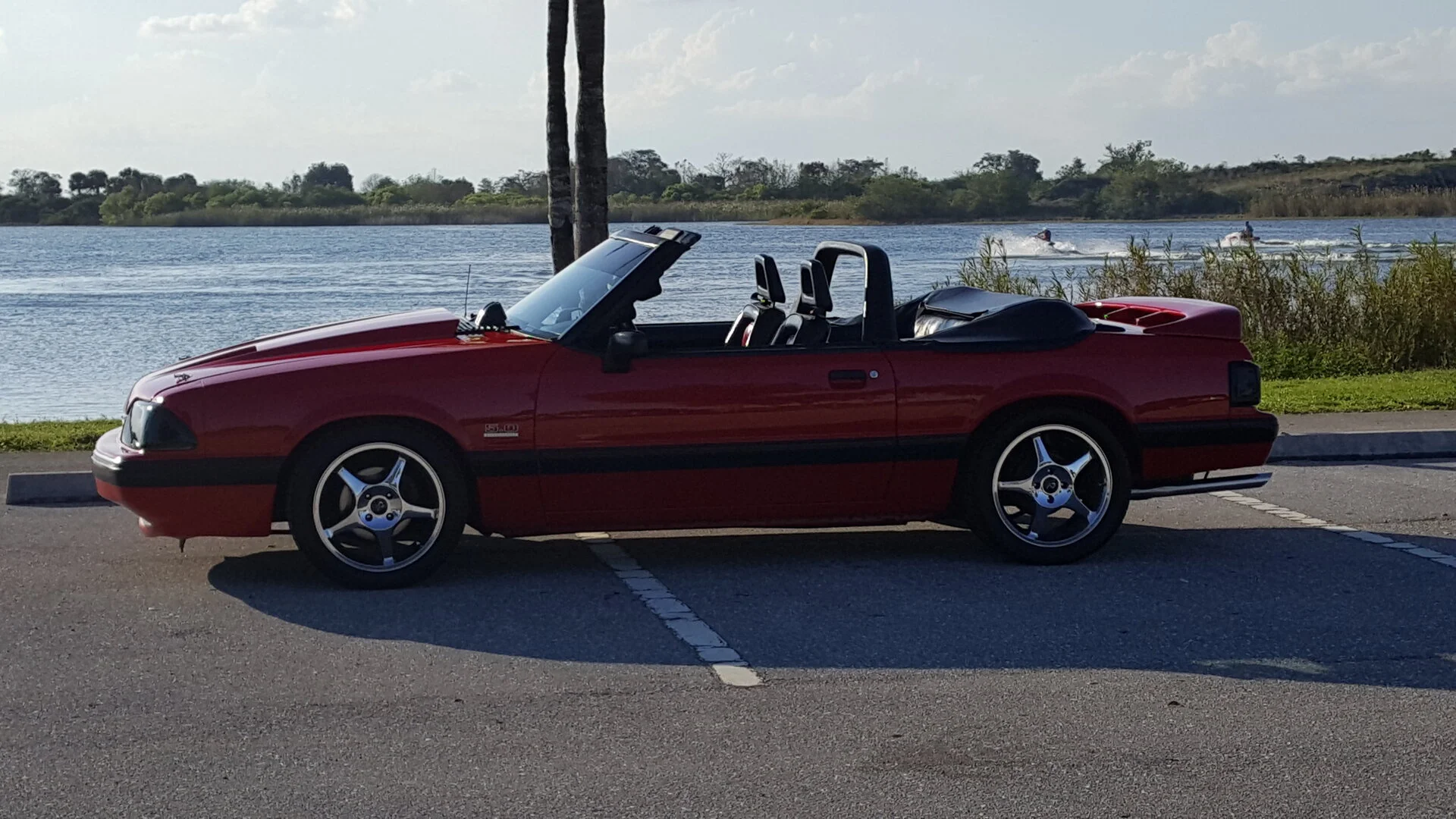

I have a 165/80r15 in the front and 275/60r15 in the back. If you’re cruising and around hammering down from stop light to stop light you don’t even notice it has skinnies on the front. A smaller stagger like a 245 and 275 will be completely fine.
