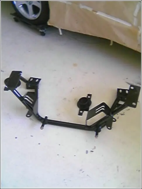

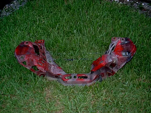

Yeah, the qa1 stuff is pretty much just for drag racing. I regret using the k member because it is very weak, amd proned to breaking. When I got it there weren't too manay options.

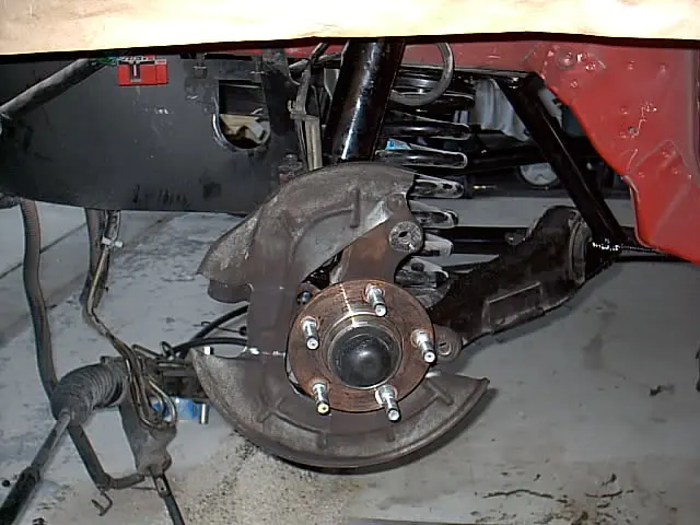

Stocker
QA1
QA1 with stock modified A-Arms.

For handling, you want a k-member that changes the stock geometry like MM, Griggs, QA1, A47. The AJE and other drag race k-members are all about saving weight to go fast in a straight line. QA1 is an oddball here because it's really too weak for road racing/auto-x but the drag racers complain about the change in geometry.
