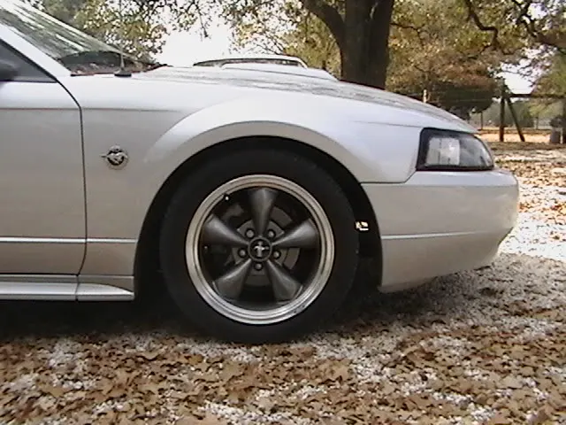

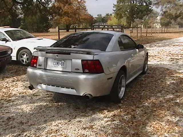

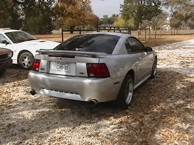

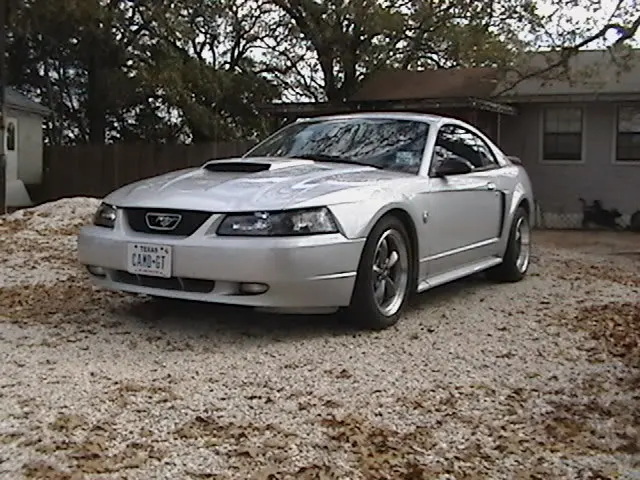

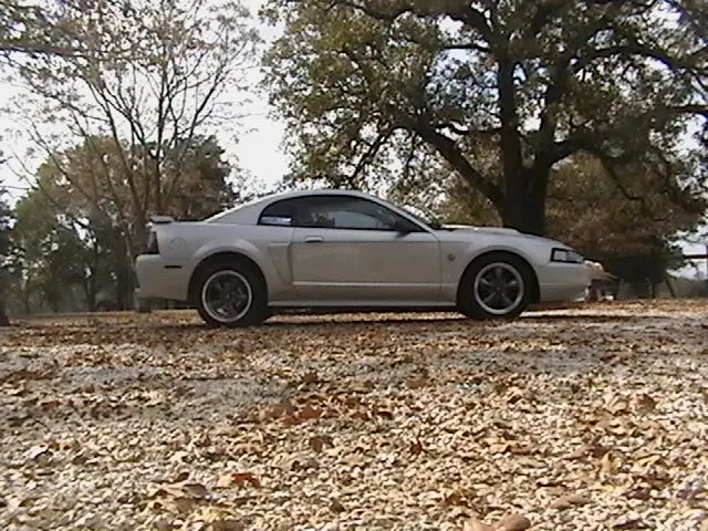

Ok here you go.

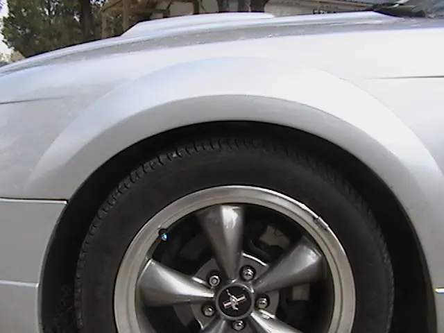

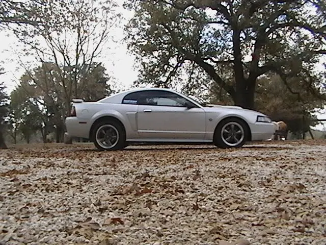

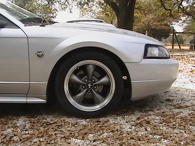

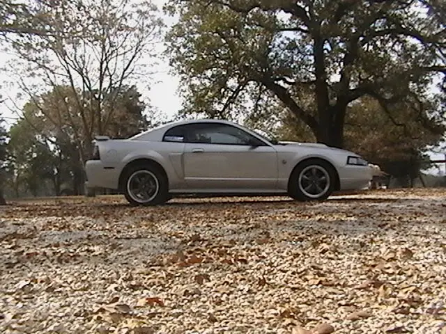

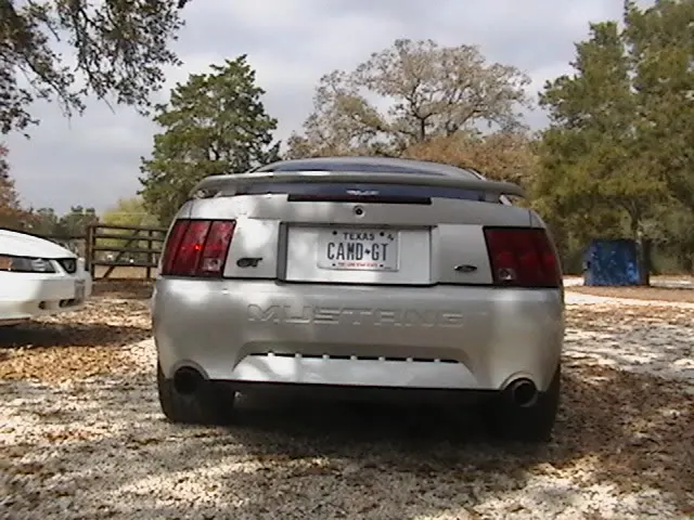

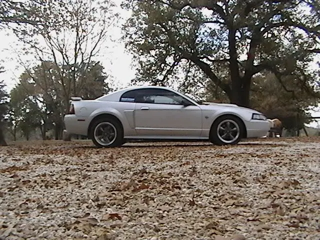

The pass side rear seriouly needs to be dropped about an inch to match the drivers side. I think we may take out the isolaters to drop it.

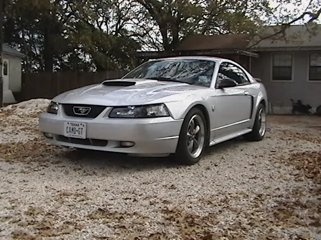

The rear is way up in the air. lol. My 2 inch drop looks slammed compared to your stang. All you need now is a little more drop, rear wing delet and bullitt sideskirts and its goona look sick. Did I mention I want your car??:hail2: :hail2:
Well i guess you dont have LTs LOL. We were almost thinking of raising the front a tad so it will clear speed bumps. I think I dropped it a 1 1/2 to a 1 3/4. BUT I can still drop it almost another 2 inches if I wanted to :D. But it looks perfect to me there so I dont want it up anymore.

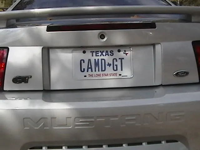

BTW I love the plates, freegin everyone is all nailing their cars as they go past and revving up and all lookin at me and crap...good times. :D Ill get some more vids up sometime, and I think I put some pics up before of te install :shrug: .
