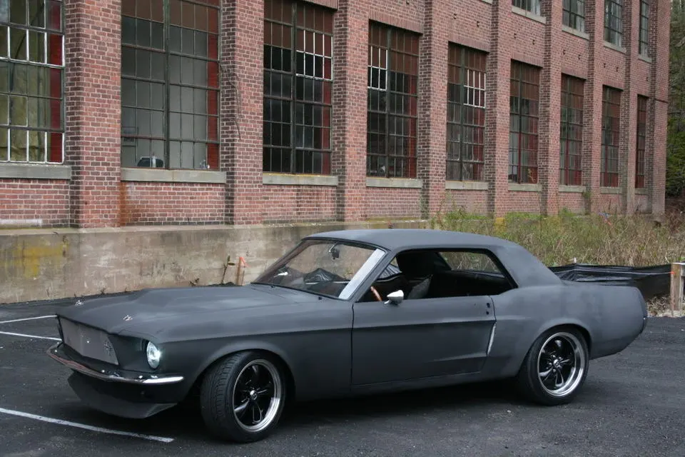

18"x9.5 rears 17x7 Fronts on mine with a staggered offset for a nice lip on the rears.

tcrote5516~ what year is your car? i like the way yours looks and the sizes are the sizes i was considering but dont know if i can tuck those 18X9.5 under the rear of my 66, but i would really like to!

I may end up going the staggered route then, cant really tell a difference in height.
Is your car finished tcrote5516? I dig the half mad max half show car look.

FireManSam: Its a 67. I did some custom work on the headlight buckets and some more custom sheet metal work for the side scoops. 65-66 is a little tighter in the rear then the 67s but you can make anything fit...its just a matter of work. The rears are made for the 96+ Mustangs with a 1/4" spacer and part of the bump stop cut down. I also have the rear dropped 2". No rubbing front or rear.
LOL I call it color changing paint...it goes from one shad of black to another

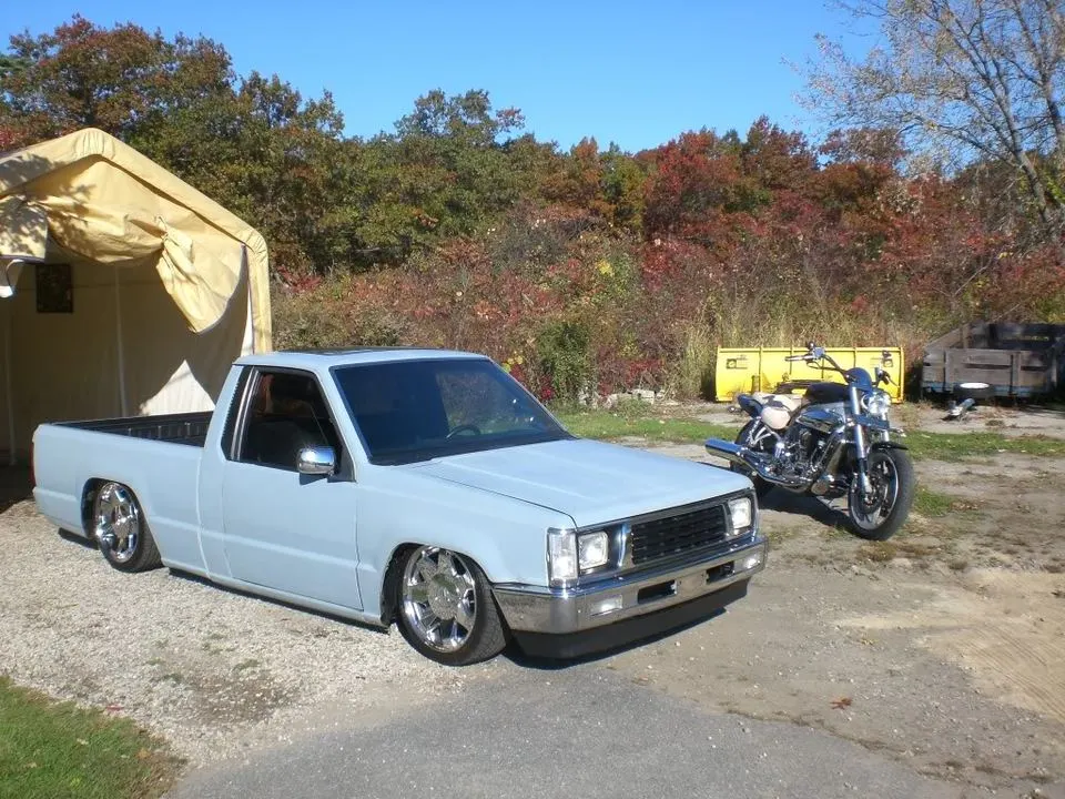

Its going into the booth next month for paint...but I cant drive it anywhere without someone telling me I need to leave it flat black. I also have a bagged pickup I have left flat grey for 2 years with an "under construction" decal

tcrote5516~ i like that bike you have sittin over beside the truck! if my eyes dont decieve me that is a VROD? I have an 03 anniversary edition back home! haha

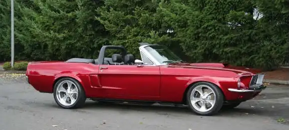

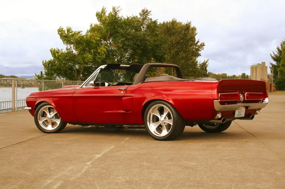

17's up front and 18's out back.
