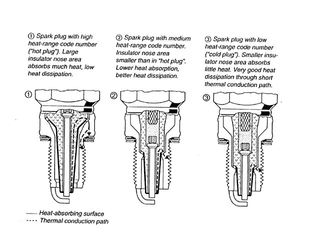

From The Secret Life of Spark Plugs {LINK}
Different lengths of insulator nose result in varied characteristics and different heat ranges. Heat is dissipated from the insulator nose through the center electrode and the inner seal ring to the spark-plug shell. If the insulator nose is long, the heat-transfer point formed by the seal ring is further away from the hottest point on the insulator nose than with a short one. So it follows that spark plugs with a long insulator nose can absorb more heat than plugs with a short insulator nose.

Thanks for the info. I'll have to look at the plugs I have and figure out what their heat range is.
