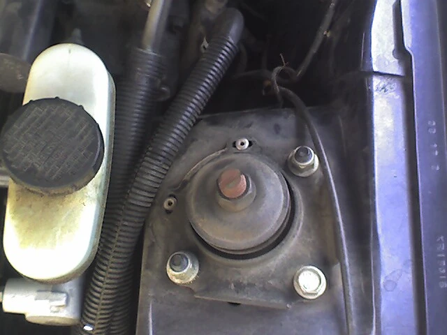

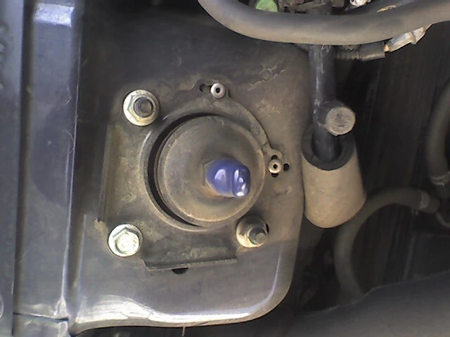

Why do the stock CC plates look like this?
bullitt 5561
Jun 18, 2006
75
whys are the rivets on the passenger side diff than the ones on the driver side?
The rivets are different to adjust the Camber setting to within specs, altough there isn't much adjustment it can be tweeked a little. All the loose Ford tolerances that are stacked up from side to side will often create the situation you have. Before I put CC plates on mine they were the same as yours.
