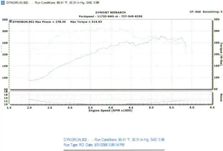

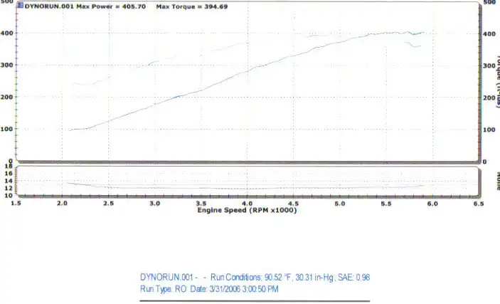

Ever since I had built the new motor ive been having this problem. When the car is cold, it feels decently fast but once it warms up its just plain slow. I have confirmed this with trap speeds, and now dyno charts. It seems like the car is pulling timing when the car gets hot. Problem is, the people that have seen this car work, dont think its actually getting hot. I had a napa sensor that i guessed might have been giving false readings, so today I swapped it for an OEM Ford one ($18 used:nonono: ). That wasnt the case, once the car warms up and I got WOT, it jumps up to 254*. In my first pull, I guess it didnt get hot enough and stayed at 18* total timing at WOT. On the second run, it pulled timing down to 8.5* TOTAL. The guys at the shop think that its a short in the wire or something. What do you guys think? How do I start to diagnose this? I have copys of my CalCon datalogs for both of these runs if anyone wants to take a look. Thanks guys.
Keep in mind that these pulls are within 10 minutes of each other, with no change to my tune

If you used the T4M0 spark the ECT will pull 8.5* at 254* temp - on a J4J1 it'll pull almsot 12* - so IF your ECT is sending the right temp and IF you are running the spark curve you should be with a blower, your total spark is probably correct. That's not to say the motor is right - because if the ECT temp is really 254 (254 is max - so it may be higher) then you have other issues. The ECT is pulling spark for a reason - a good reason. If it were my car I wouldn't worry about the ECT adder pulling spark, I'd worry about the temp being so high. That said, I doubt the temp IS that high, you either have a bad ECT, a wiring problem an air bubble in contact with the ECT instead of coolant or the TwEECer is going banana's. The motor really would not run good at that temp - at 250* and above, I'd guess you'd be well past the puking coolant stage.
The car really runs fine, just pulls timing. I dont have the means to do a compression test here at USF, but ill be home easter weekend and I can try then. I dont think the ECT is bad, thats the second sensor ive installed, and this one is OEM Ford. How can I check the wiring? Heres the link to the thread on EECTuning if you want to look at their guesses.
