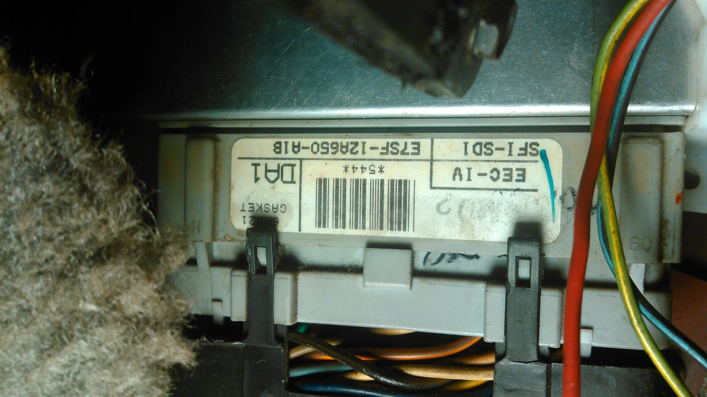

maybe this is why mine doesn't work. EEC is 87/88, engine is a 90. Waiving the white flag.:dead:

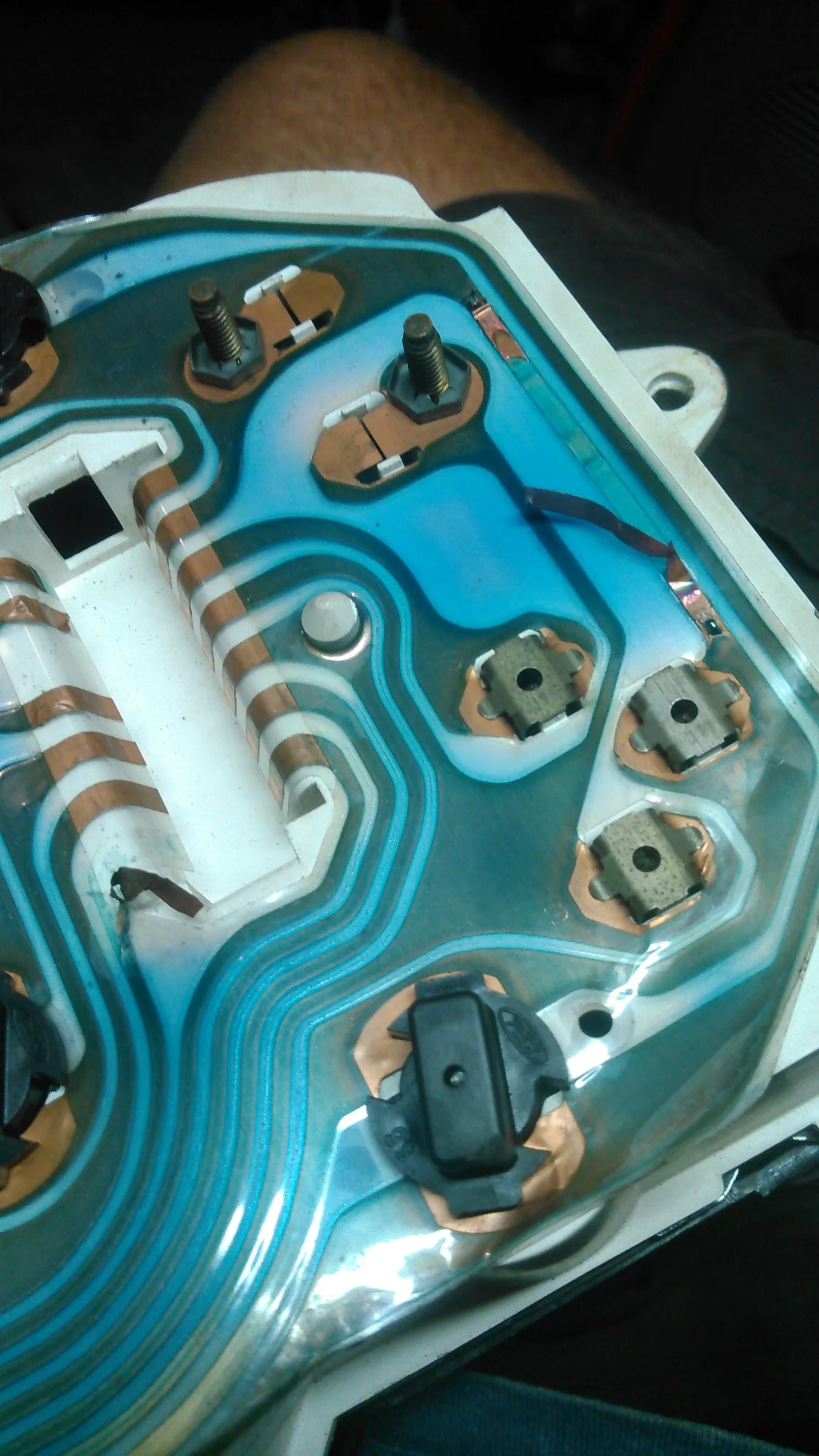

Finally! Found the problem, or another problem. I had continuity through everything to the cluster and the light bulb worked. Followed the circuit board looking plastic sheet on back of instrument cluster and found this (see pic) the broken circuit on right is connected to almost all the bulbs, mostly idiot lights. They make copper tape to fix this?

86-88 speed density 5.0 mustangs do not have a functioning check engine light. The bulb is there, but it's not wired in. The 2.3L cars DID have a functioning CEL those years.
First 5.0 to get a working cel was the 88 Cali cars with mass air. Mass air swapped 87-88 cars won't have the CEL automatically work. You still need to add another wire first

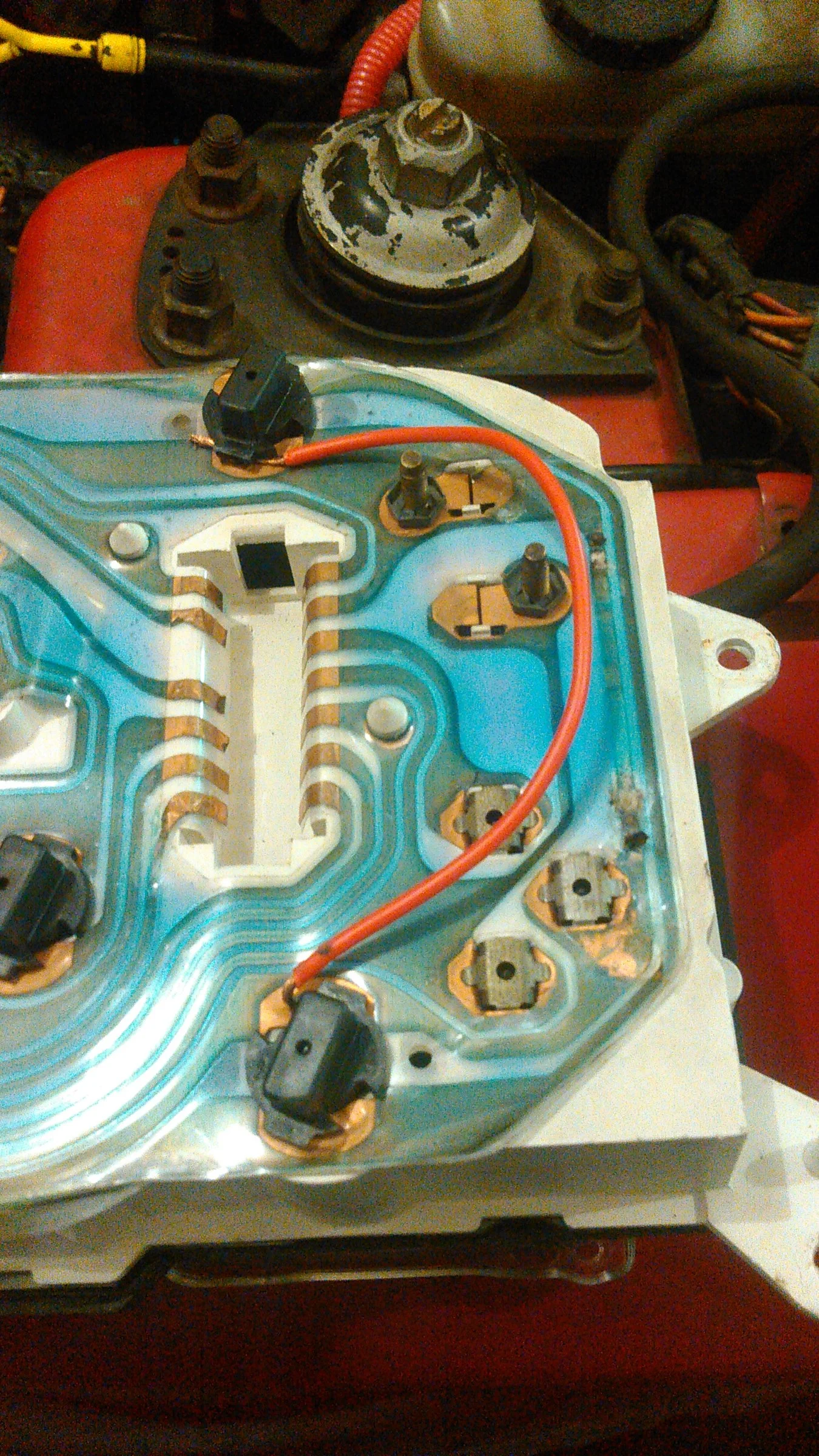

Is just jump a wire under the grounding tabs of the bulb sockets

Then I'm done. The light works now with the jumper even though I bought the scan tool. Thought it worked like a new car with all the sensors. Thanks to everyone for the help.
