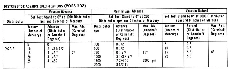

In performance driving (dragstrip, track) it is not necessary, or even desirable, but on the street it's a very good idea for driveability. People who fancy themselves driving hotrod cars eliminate vacuum advance. The only Ford that came with no vacuum advance, though, was the 289 High Performance. The 390GT, 428 CobraJet, BOSS 302, BOSS 429, BOSS 351, all had vacuum advance.

At the dragstrip the vacuum advance would basically never be used, so it's only function would be to occasionally screw up your carefully set-up timing curve.
For street driving, you might consider having the distributor curved to the BOSS 302 specs, at least as a starting point. Use the vacuum and centrifugal specs, and ignore the retard numbers.
Do you have a distributor vacuum control valve?
Here's the BOSS adjustment table:

It's not the max limit that's critical, so much as the curve getting there. Yeah, you don't want to exceed the total, but the rate of increase as the rpm or vacuum increases is what will ping, or lose power, if the advance opens too fast or too slow. This is where it really pays to have a pro with special equipment set up the distributor. I have adjusted quite a few Ford distributors, and I've never seen one that wasn't out of spec when I started. I have seen some well set-up engines run lousy, and all I did was bring the curves into Ford spec and they stated smoking tires. You can usually get a distributor done for under $100, and unless you're the one in a hundred that has a properly set-up distributor going in, you'll feel the difference.
