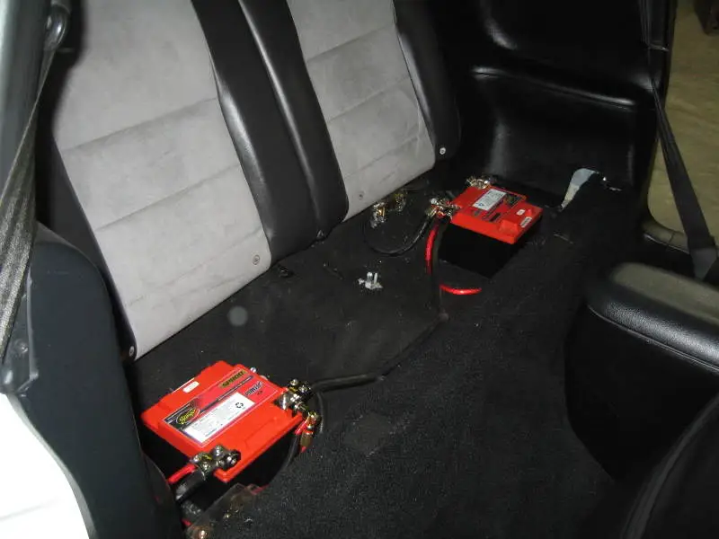

I have to admit, it’s a good looking battery and performs great under duress, but I’m personally going with an Optima mainly for the fact that it promotes fumeless operation. Kind of a must for us guys with the trunk mount battery conversion.
Anyone have a picture of the "unique" battery hold down required when mounting it?
When I am at home, I'll go ahead and take a picture of the custom part that holds down my battery tight.
