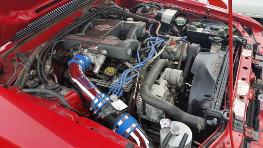

Anyone know anything about these? The price range is crazy. Is it worth getting the cheapest just to try? AEM electronics at $85.
My whole top end is aftermarket.
