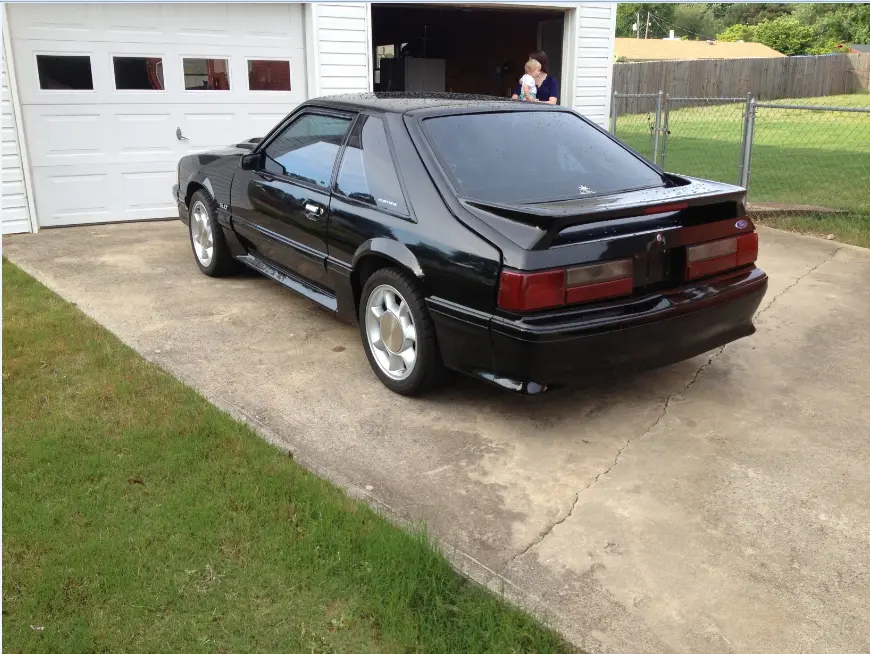

My buddy just bought an 88 GT (pictured below). It's got the whole HCI thing done. I drove it back most of the way (200 miles). It didn't take me long to realize that 1st gear was USELESS.

I could floor the car in 5th and scare myself to death. So when we got back I used an online calculator and found that for an 88 GT, at 70 mph and 3100 rpm it would have to have a 4.90 gear ratio :jaw:
Another one for the WTF file until he gets the gears out and counts the teeth. I bet that transmission isn't stock...

It probably has a 4-cylinder T-5 in it.
3.79 first gear ratio and either a .79 or .85 5th gear ratio in those bad boys. Toss some 3.73's in the rear and you've got truck gearing
Do your calculator based on that and see what you get for numbers

He's at home tinkering now. The tach was off by 1000 for one thing. Bu t when you turn the wheel and measure the driveshaft it puts it at 2.73s. Transmission HAS to be a 4 cylinder just as 5L5 and others have said.
