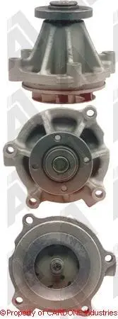

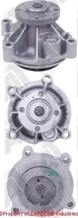

Here are the pictures of both water pumps. The top picture is of the 2000 water pump and the lower picture is of the 2002 water pump. The 2000 water pump has a Cardone reman part # 58569, and the 2002 water pump has a Cardone reman part # 58583. Based on this info, something is different, like the others are saying. Hope this helps. Good luck, Tommy.
