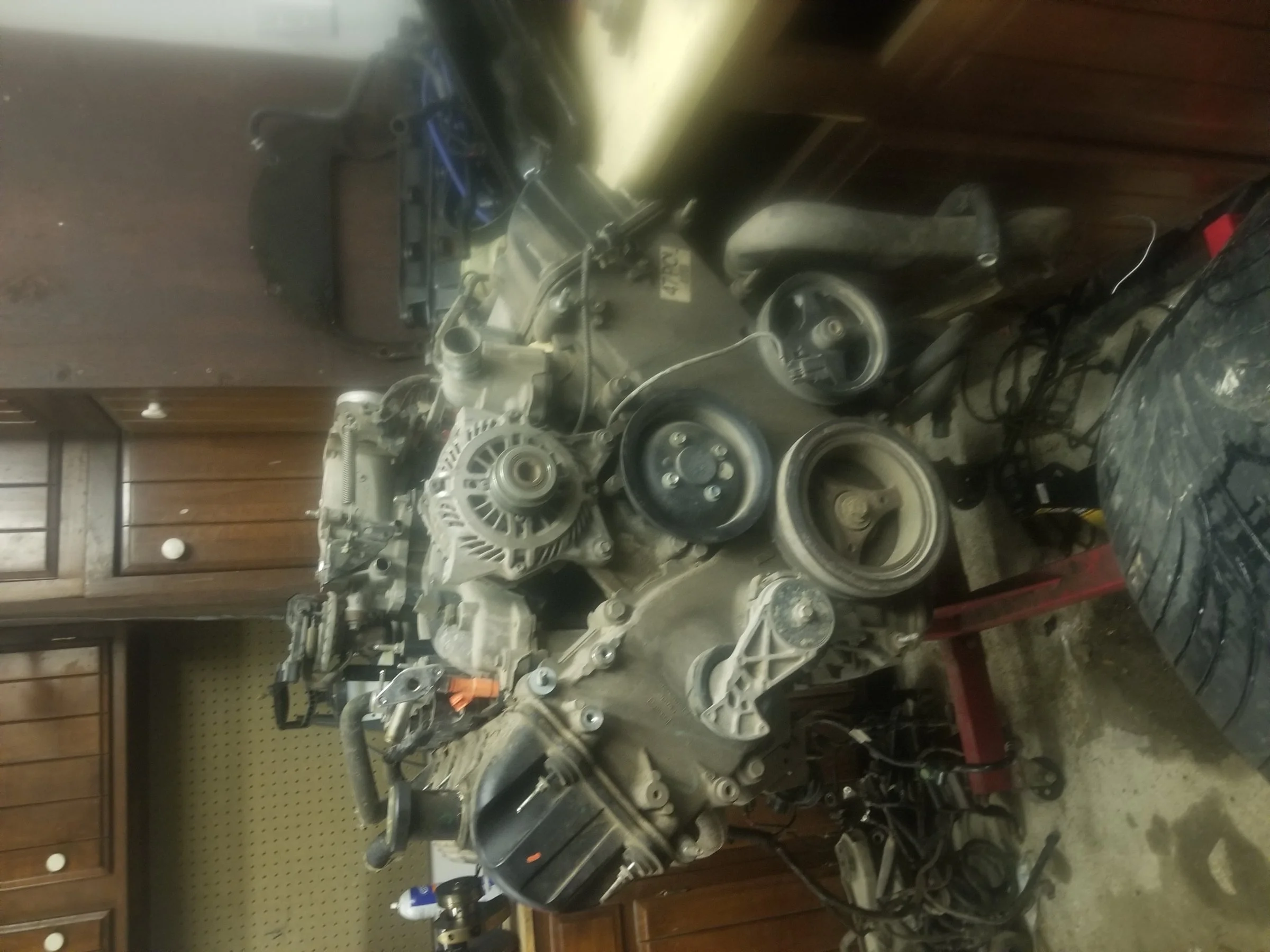

This is what I'm working with

If asking for an educated based upon the picture posted, I see:
  • An electronic EGR valve. These appeared in the 2003+ model year. Previous MY's had a vacuum operated EGR valve.
  • An ECT sensor in the intake coolant crossover. These were removed in very late model years (2005+).
  • It appears to have coil on plugs(COP). Which means 1998+ Model year.
  • The 2005+ CV model year uses an electronic throttle. The motor in the picture appears to have a normal cable driven throttle.
Plenty of people have done it. Just put both motors on an engine stand. My the donor motor look like the original. Take TONS of pictures.
