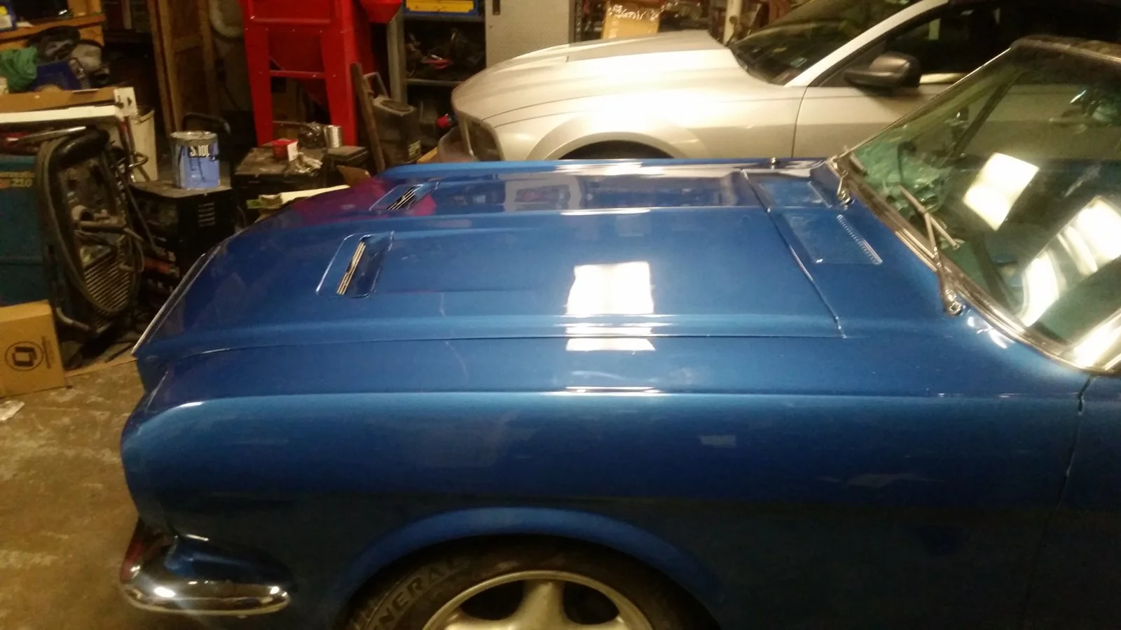

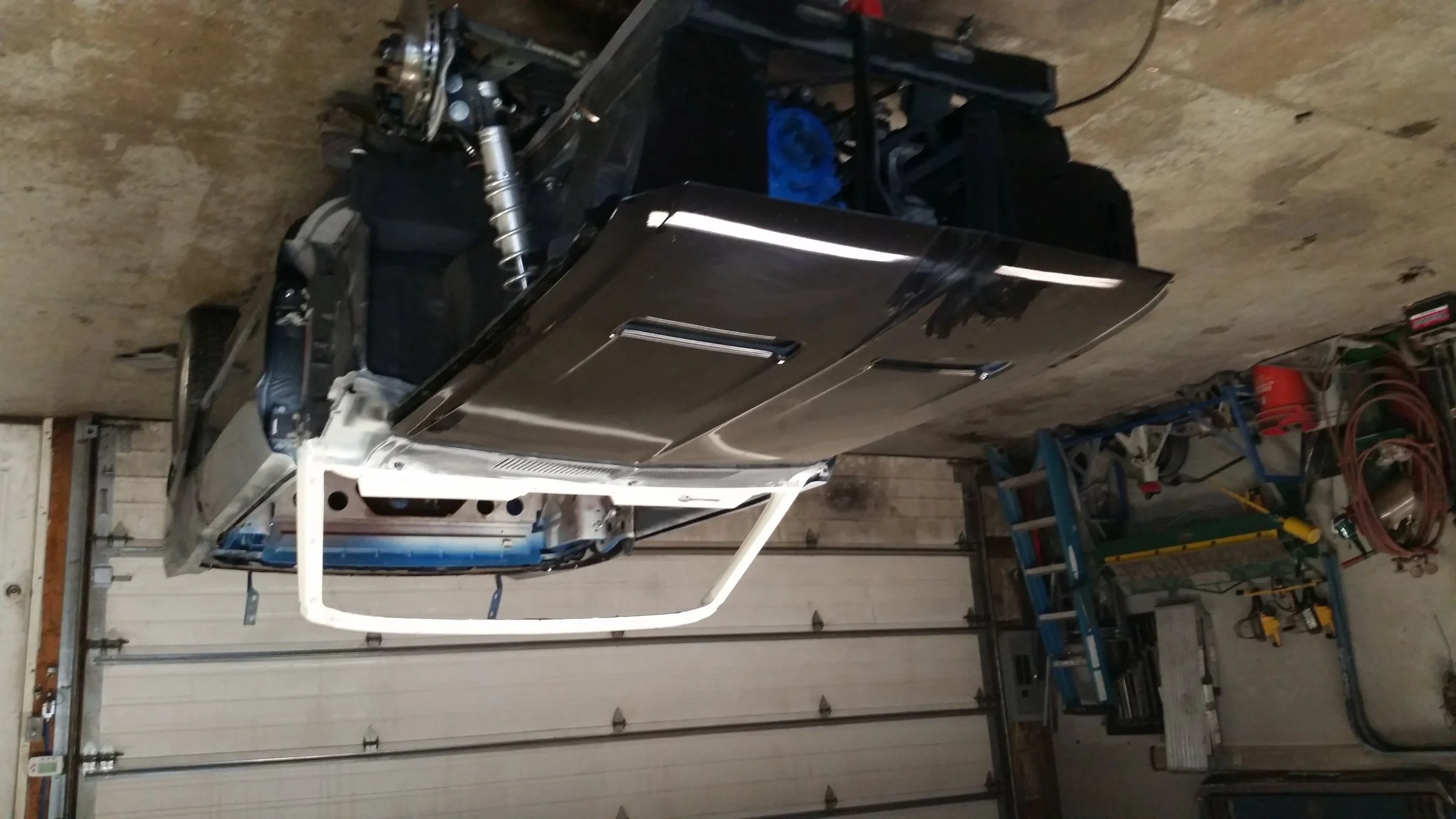

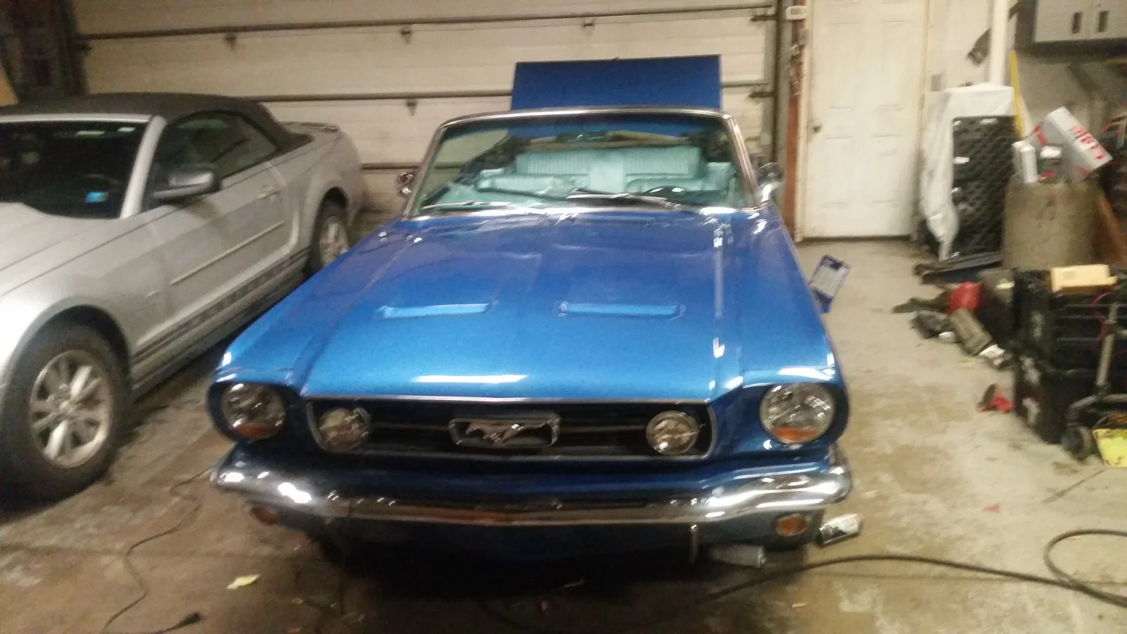

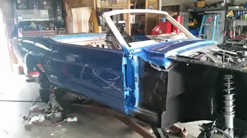

so this can be done takes two hoods and a little love to make it fit
