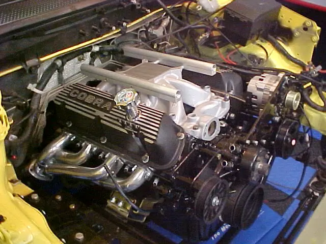

heres a picture of my engine- it has 1.6 rollers and cobra valve covers
