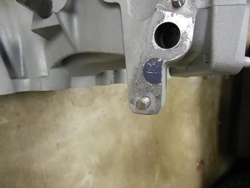

2. The EGR mount just behind the throttle body needs to be shortened up a bit on the bottom just below the lower EGR mounting stud. There is plenty of rounded extra material hanging down there and I just filed/ground it flat to clear the covers.

Here's a pic of the EGR area that needs to be ground down a bit. I don't run an EGR and usually have just a blockoff plate over this area, so if you still have EGR you may have to grind the bottom to match.
