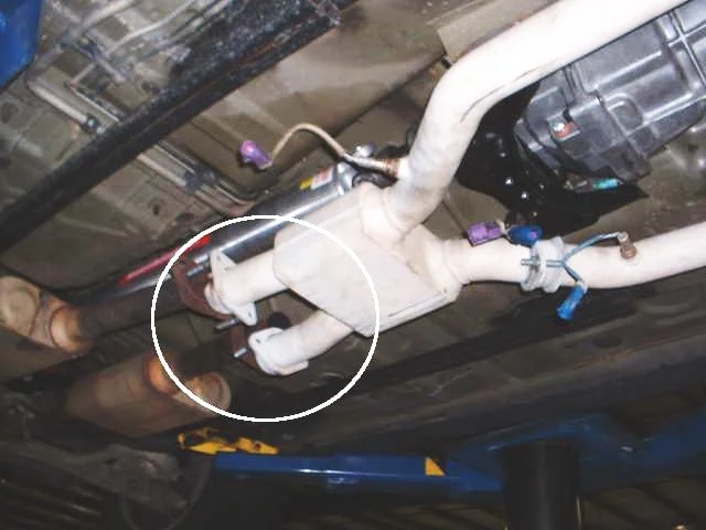

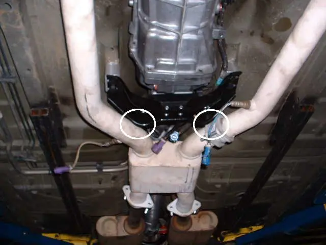

Doubtful. The T-56 transmission mount sits further back than the T-45.
Admittedly my T-56 is a D&D conversion, so I could be wrong about a stock 03. It's possible the stock 03 crossmember isn't as beefy as the one from the D&D kit.
