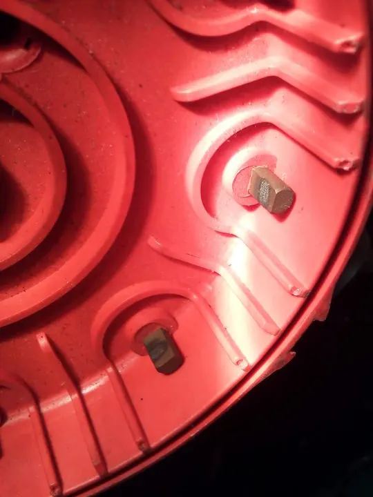

hey guys drove the car for the first time this year yesterday. and i have a miss. the rotor hat rust on the end of it and the contacts on the cap look like they were welded with out the gas turned on lol lots of little holes and the metal crumbles off. would that cause my miss? there are pictures here of it. not sure if you can see it or not

That's normal. But really inspect the cap for cracks.
You might wanna run codes to get to the cylinder balance test. It will help you narrow down the miss.
Good luck.
