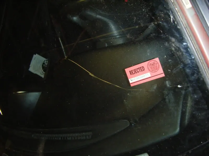

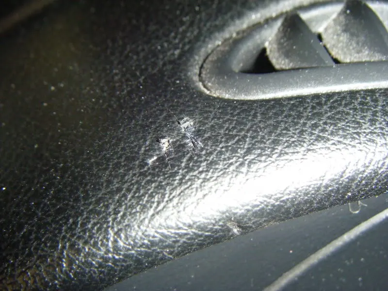

Didnt go so well.. old glass is out.. but the urethane from the factory was so thick. welding or picture wire would heat up and break. So we resorted to sawzall and a tarp.. Small ding in the dash :( but otherwise the windshield is out and we are prepping to put the new one in... would of went fine if we didnt get the small ding in the dash...
and since im bothered by every imperfection im on the hunt for a new black dash if i cant find one for $50 ill just leave this one in till i get some $$$ i can swap a dash in about 3 hours now anyway.

And i have a small ding in the dash probably cost me about $100 for a new dash pad.

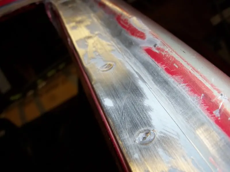

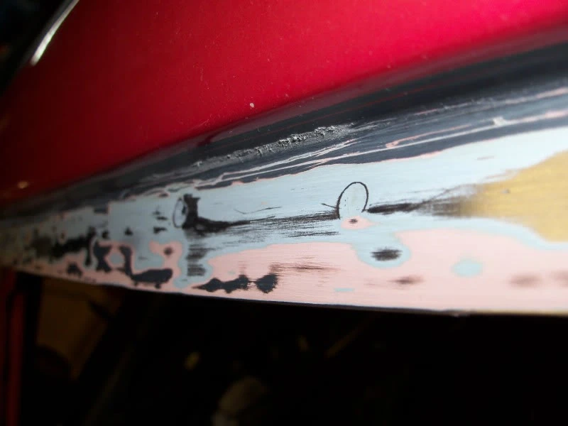

However after all of this i read that urethane bonds best to urethane and your not supposed to come clean down to metal. But i thought the best way to prep would be go down to bare metal.. so now im going to pinch weld primer the whole area.

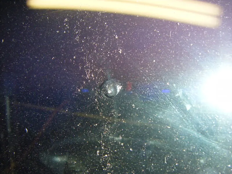

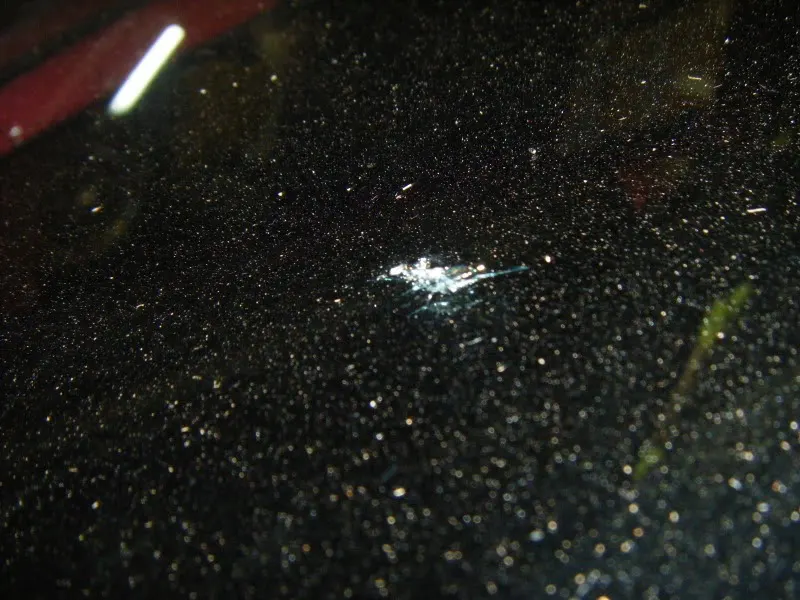

The car had 2 big rock chips having 220+K on the car... Then i was blowing something off with the air nozzle and it shot off up in to the air and split the windshield.
The dash isnt that big of a deal... it sounds worst then it looks:
