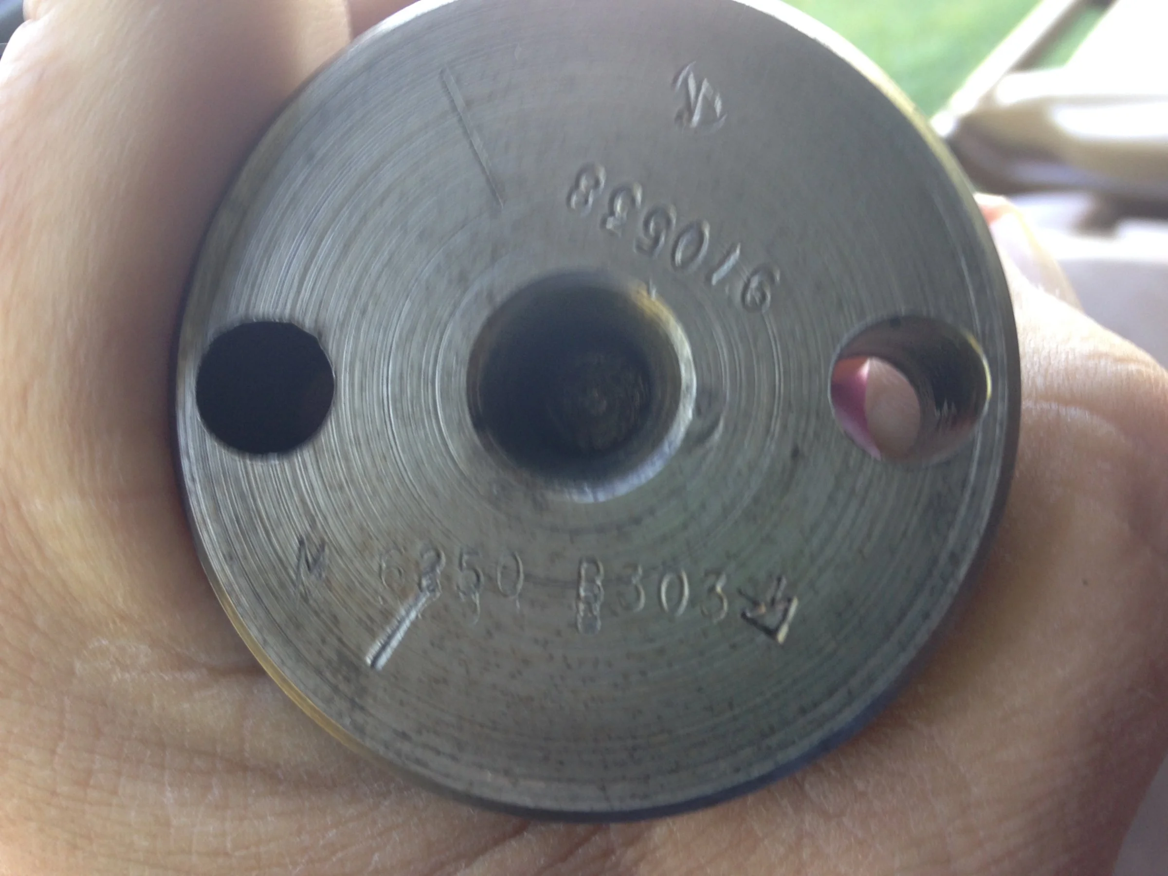

My b cam was so powerful it teleported my car right out of the garage!
