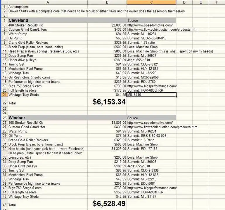

I found this on another forum and the cost difference between a cleveland and a windsor is minimal.
_____________________________
yeah but this is comparing apples to oranges again. stock (worked) cleveland heads vs aftermarket windsor heads. if you were comparing apples to apples and used aftermarket heads on both you'd get a different bottom line.
the windsor heads thye used were victor Jr.s at $1329
staying with the E'brock heads for the cleveland, they only have the performer RPM for the it, you're looking at $1942.
i don't like comparisons that use stock heads on one build and aftermarket on the other, if the comparsion id against ported stock heads then use that for both builds. the Power heads cnc ported heads cost about the same as the $800 they used for the Clevie head prep and flow as well as or better than most aftermarket heads but probably a little less than the victor jr.s, this may give the cleveland engine a slight advantage on the dyno though, but anyway i like comparisons that are more equal in parts used.
in most cases a windsor build will be cheaper than a cleveland build, i believe that comparison is a little biased in favor of the cleveland, personally.
He used the stock heads because worked over stock 4v heads will outflow the Edelbrock heads. The only benefit the Edelbrock heads at that point is weight savings which isn't enough. Also worked over stock 4V heads perform as well or better than the aftermarket Windsor heads.
yes it's true that stock 4v heads flow more than E'brock heads but at the expense of port velocity, the E'brock's have much better port velocity than any stock 4v cleveland heads.
personally i'll take the better port velocity and weight savings, plus the ability to run a higher compression ratio than iron heads over all out flow numbers any day.
