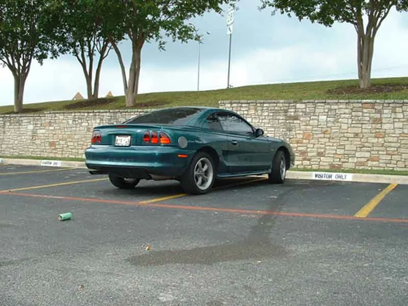

going wingless
I also got very lucky with my wing delete. I traded trunk lids with a V6 that happened to be the same color as mine in my appartment complex. He was actually looking for a winged lid. The only thing is, it doesnt match 100% with how it sits on there. I think I might need new shocks that hold the lid on for a better match up. Also his car had way more miles than mine so I had to polish the poo outta it to look as shiny as mine. I would try looking for a V6 same color, which is harder on 99+ because almost every V6 I see in that body is winged. Looks so clean wingless. and on the 94-8s they have a little lip on the end. Here is a pic: Please dont comment on how I need a drop. I already know, I just dont have a grand!
