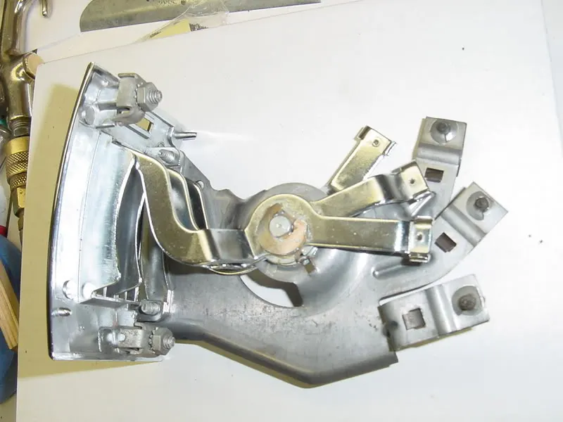

Tonight I'm going to try and remove the headlight and wiper switches, the glove box and the heater levers. I didn't get any feedback on the heater levers. Do you know how to remove them?

about the heater controls, I'm not sure, but after reading your post and since we're both confused, I put my head under the dash, and pulled myself up, and I found two 3/8 nuts, one on the top right and one behind the bottom middle of the chrome bezel, i'm guessing if you undo those two it'll come off, but i'm not sure i don't have a small enough ratchet to get there, I tried like 15 different sockets and it is a 3/8
IIRC I removed the ashtray slide bracket for easier access.

I also removed the ash tray guides and stripped out the glove box and door. I was able to see the heater control attachment points and will probably remove that tonight.
