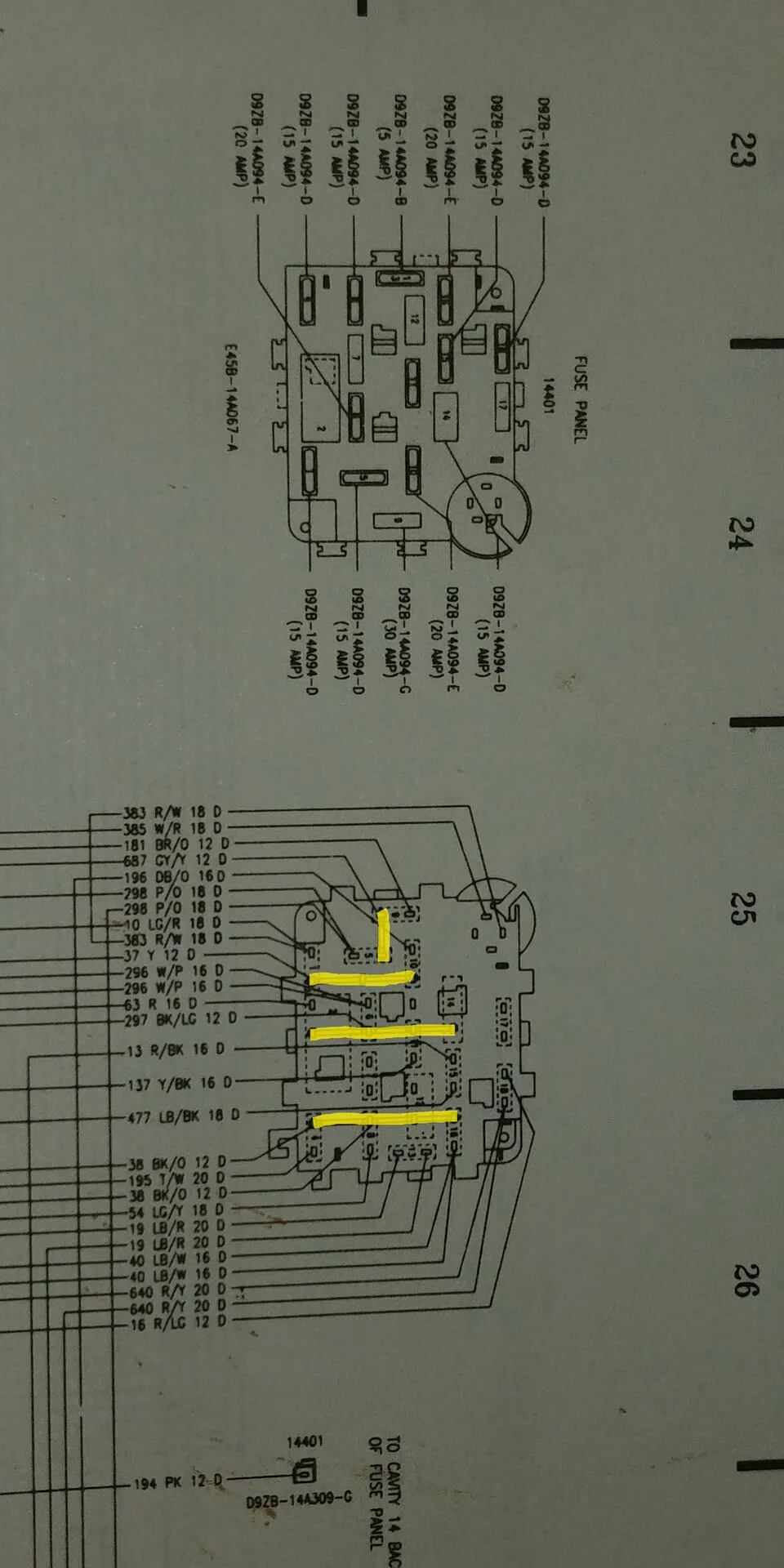

Try disconnecting the wire with draw and then probe the fuse panel for a dead circuit. Maybe probe the fuse panel first to see what is live, then disconnect the wire and check the panel for dead spots. The offensive wire could be connected to multiple fuses so your test of pulling one at a time could be misleading.
Highlighted the connected fuses.
