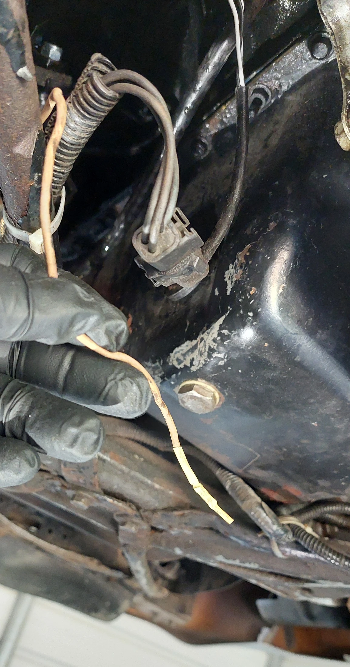

N NooStang Member Mar 15, 2024 42 6 18 Tn May 17, 2025 #1 May 17, 2025 #1 '87 5.0 GT Wire shares the loom with the LH O2 sensor. Anyone know where it connects? DMM shows 0v with key off and 10.92v in run position (engine off). Thanks for any help. Last edited: May 17, 2025

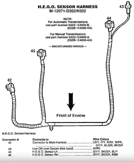

nicholase I lubed and pushed, until it was all the way in May 21, 2024 662 1,185 103 New York May 17, 2025 #2 May 17, 2025 #2 Looks like the low oil level sensor wire Reactions: Mcmahst and NooStang
