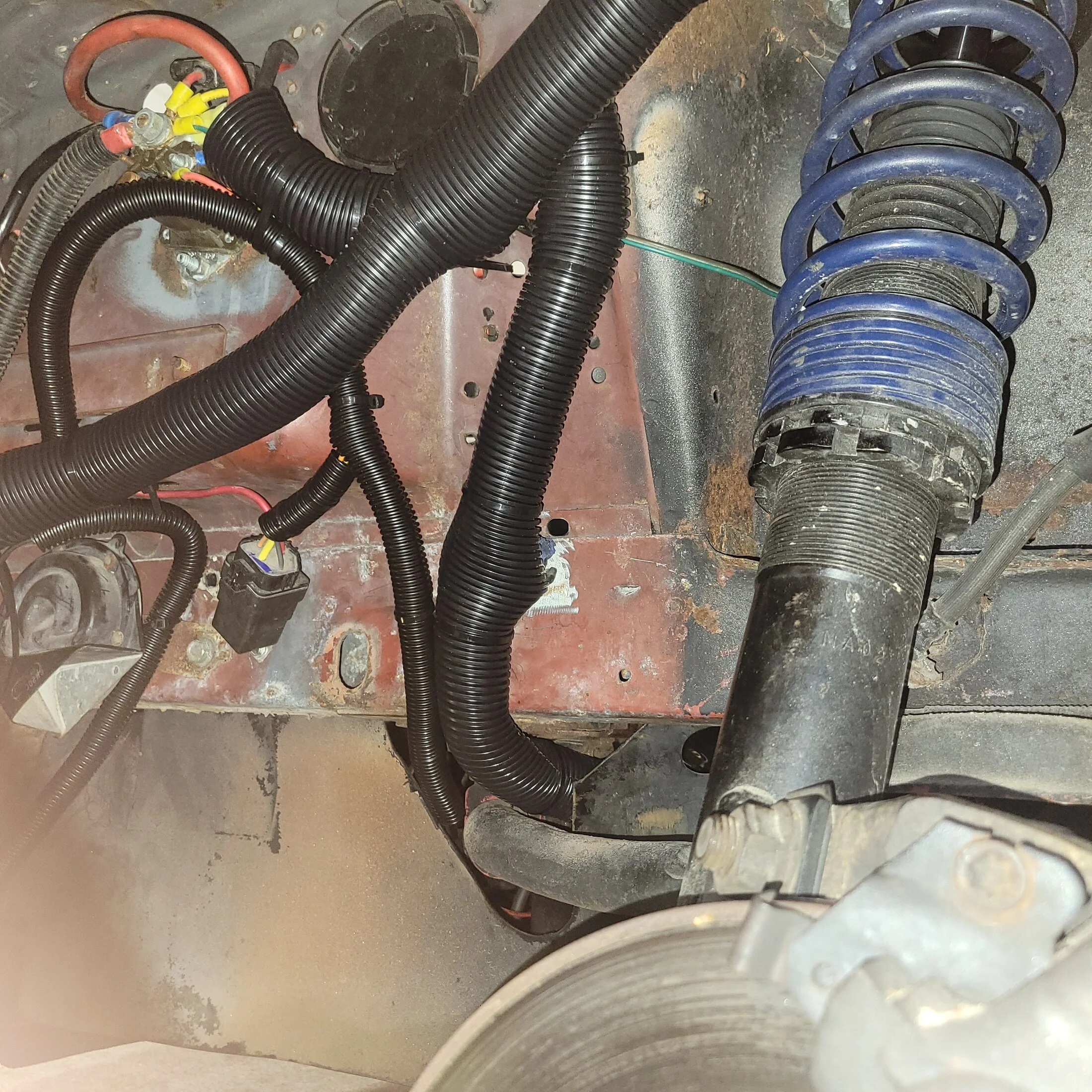

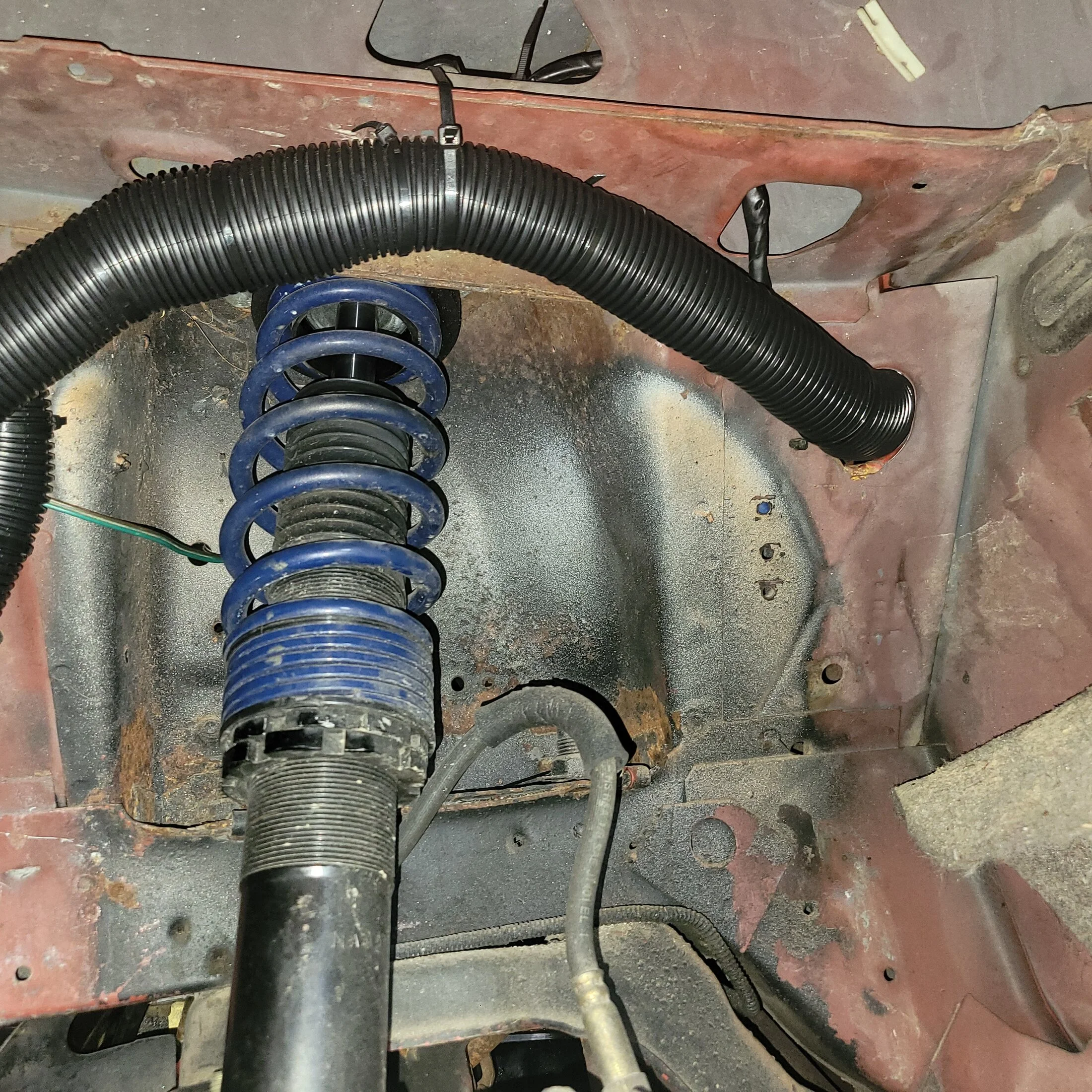

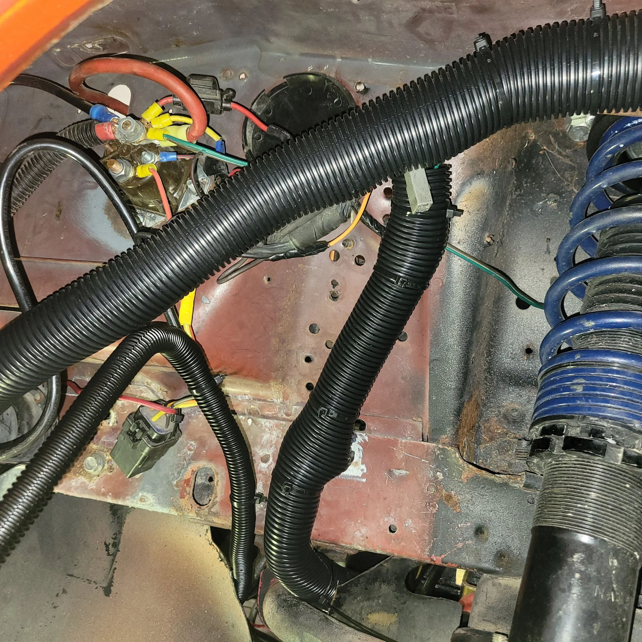

Finally got things cleaned up after moving some wires out of the engine bay.
I am happy with it now.

Will your fender liner still fit properly? I also want to note that those crimp connectors dont look all the reliable to me. And a couple of the wires look stretched coming off the unreliable crimp connectors.
Grab a 1/4" vac line and split it down the long way and use it to line the pass-thru where the red power wire goes through the fender. This will prevent it from rubbing the insulation on the edge and potentially shorting to metal.
