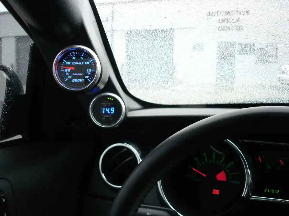

<TABLE id=HB_Mail_Container height="100%" cellSpacing=0 cellPadding=0 width="100%" border=0 UNSELECTABLE="on"><TBODY><TR height="100%" UNSELECTABLE="on" width="100%"><TD id=HB_Focus_Element vAlign=top width="100%" background="" height=250 UNSELECTABLE="off">Hey guys. I got the Autometer boost/vac gauge, as well as the wideband A/F ratio gauge. I still need to do the electrical connections. I need a wire that goes on when your lights are on, for the boost gauge, and a straight 12v source for the A/F gauge. Before I tear wires apart and make a mess, has anyone done this who can tell me ahead of time which wires to use? Thanks in advance.

There is a wire under the steering column that goes to the light switch. this will power your boost gauge and dim it also. I cant remember the color, but found it on a site somewhere. If no one else knows I will look under the dash in the morning for you. Power your A/F guage at the fuse box on the passenger side kick panel. There is an open fuse space that you can use. Get one of those add-a-link fuses from your autoparts store. Make sure you get the mini-fuse one. You will need to test the open slots with a volt meter to find the one that is powered only when the switch is on.
<TABLE id=HB_Mail_Container height="100%" cellSpacing=0 cellPadding=0 width="100%" border=0 UNSELECTABLE="on"><TBODY><TR height="100%" UNSELECTABLE="on" width="100%"><TD id=HB_Focus_Element vAlign=top width="100%" background="" height=250 UNSELECTABLE="off">Thanks guys, but I already finished it. I found a lights wire behing the light switch (imagine that :rolleyes: ), and i found a constant 12V behind the speedo cluster, which made it easy to hide the wires. everything works great! thanks guys. here is a pic of what i just finished.
