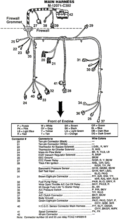

im about to buy an 86 coupe that was in a fire, all the wires on the passenger in the engine bay around the solenoid and bout the 3 ft forward burned up, alt wiring burned up, i was wanting to know if that harness connected into the main engine harness, or are those seperate? its going carbed so i just want to know if thats part of the headlight harness or if its part of the main comp harness???
I think the passenger side, dont quote me, But im sure thats where the computer harness comes out and the headlights are on the drivers side. Howerver the harnesses may be hooked up together, once again not sure, U may need both to make a complete circut but i doubt it.
Diagram courtsey of Tmoss & Stang&2birds See more at http://www.veryuseful.com/mustang/tech/engine/
Note the connector table, you may find what you need there.
