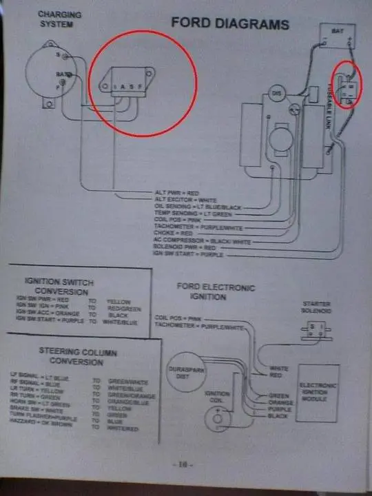

Speaking of things that don't make sense, the charging system, Can someone explain to me what the two things circles are? Are they both the starter relay?

The one on the left is your voltage regulator. It is likely a black box about the size of a rubick's cube w/ wires running to your alternator.
The one on the right is your starter ssolenoid. It will be wired directly to your positive battery terminal.

Left circle is the Voltage regulator, and the right item is the solenoid.

Thanks for clarifying the markings.
