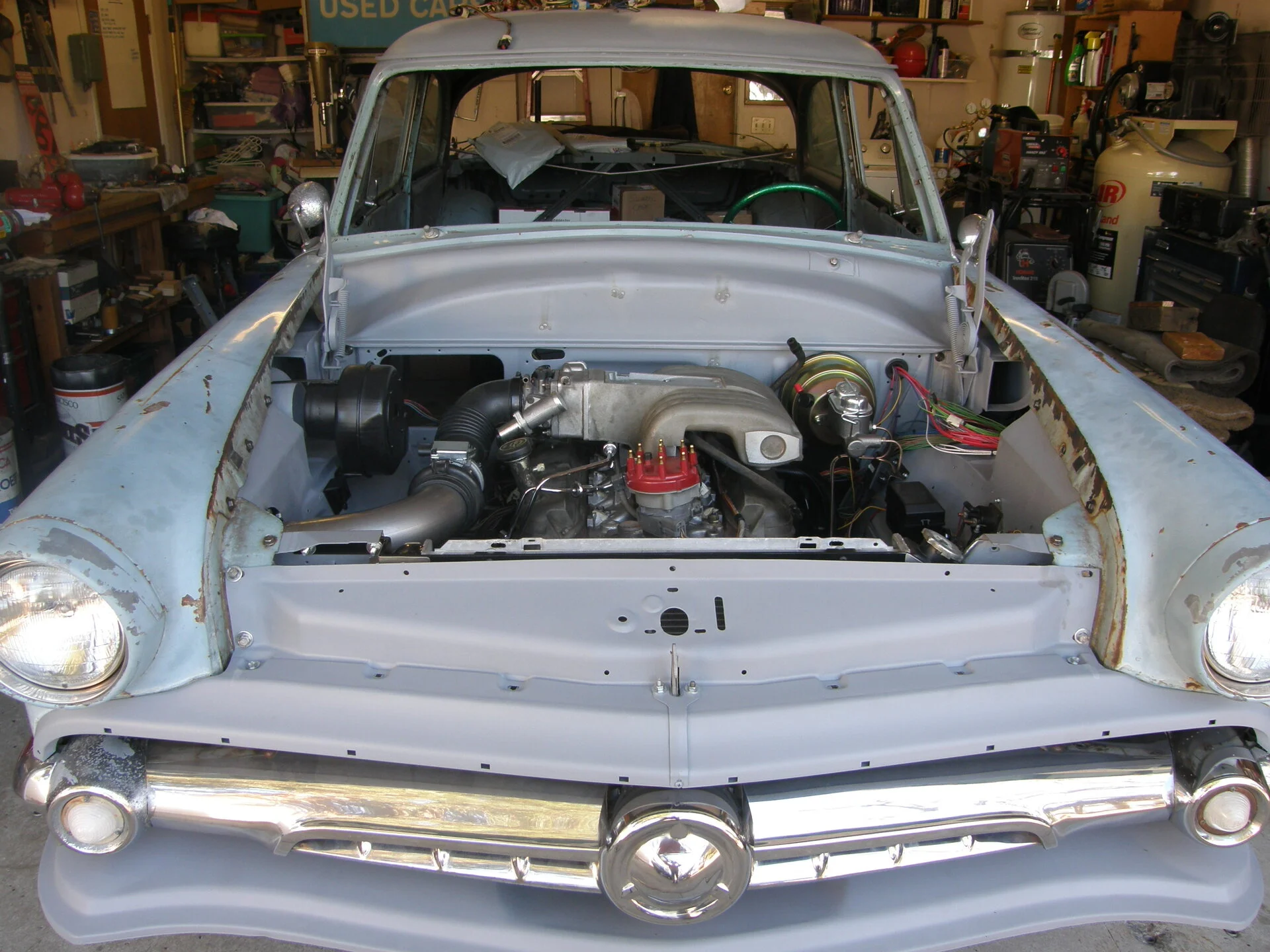

Is there enough hood space for the EFI intake? :shrug:
What if they smog check your 54? :jester:
Tons of clearance for the intake. Also, it's smog exempt 'cause it's registered as a '54!
I figured a factory oil bath air cleaner on the original engine would require lots of hood clearance. Do you think there is enough side clearance for a 351? I have a relative who would rather get an EFI roller block from a truck than rebuild a flat head for a 53 Merc. Thanks for the pic!
