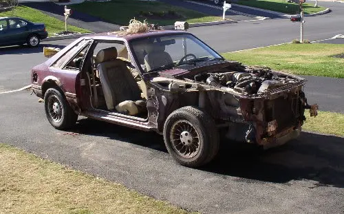

'Chelle,
Reading through this, I can see how much fun you're having! I remember 25 years ago scavenging everything from a rusted-out 68 Cougar I was driving into a clean 67 Mustang with no Drivetrain. It's fun.
also recently, stripping the 88 GT for the Cobra. Every cut, scratch, and gouge was worth it.
You're going to have a great 'stang when you are done!
