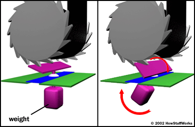

Aren't they centrifugally locked (I think that's what it's called, but I've been drinking)? Meaning when you hit the brakes (or a tree), they'll lock up? Those will pull out fairly easily even when you try to force the lock with a quick pull.
Mine do the same thing. After a while, they actually start dropping a little until I pull on them to tighten up again. It used to concern me a lot but I slammed on my brakes a few times at some point to test them and they locked each and every time. I'm still not sure if they are supposed to be like this but I feel a little bit more secure now. I do want to get a new set of seatbelts at some point to eliminate the slack I keep getting. I've always wondered if this problem is common or not so I'm interested in everyone's experience here.

The front seatbelt adjusters on my 89 lock when you hit the brakes hard. That is by design; there is a swinging gizmo that locks the motion of the reel on sudden changes in velocity. It's the same design as used in airplanes built before 1940; it's called an inertia lock.
Inertia lock! That's the right words.
