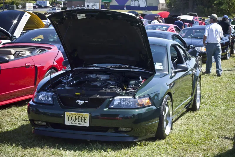

HAHAHAHA that made me crack up! I have a JLT ram air intake which keeps the filter under the hood. If your worried about deep sea fishing being an issue, get the JLT RAI. I noticed a small seat of the pants gain and the car seems to rev a lot faster now. Definitely a worthwhile $65 craigslist mod!
You can kinda see it in the pic, sorry I don't have a better underhood shot.
