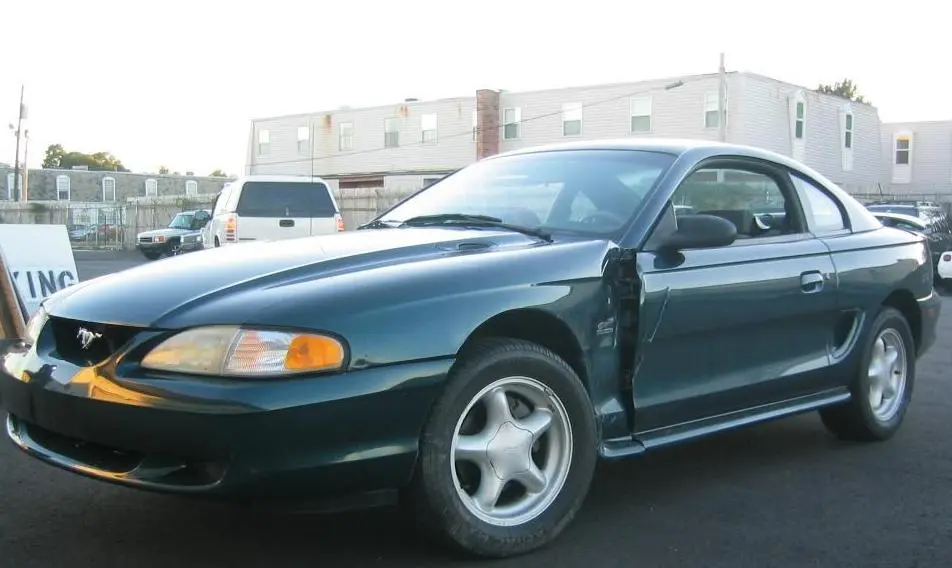

but what is it exactly about 245w tires that's bad? not wide enough? Ok this is the question then? can i fit 255/50 16 on stock rims? cuz if i can then i'm gonna get dunlop 5000, i think they will kick a$$!!! they're WR rated, should be awesome. Anyone have them?
also found out that the steering rack is busted , I will need some options to replace it soon...
Here's a pic of my poor stang
