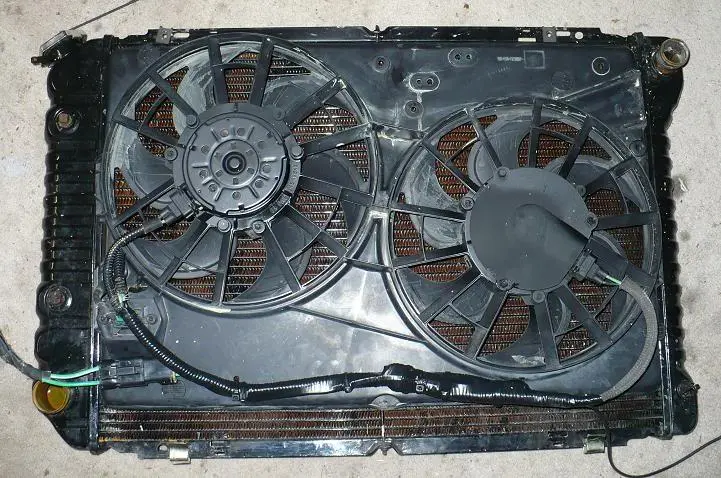

Although the Contour fan doesn't move quite as much air (about 3,600 cfm), it covers more surface area of the radiator with its dual 10" fans than the single 18" Mark VIII fan does.
Either fan would be more than sufficient for even some of the highest strung small blocks. I've got a Contour Dual fan set up on my '06 F150 FX4 and it cools the big 5.4L 3V with no issue at all.

Contour fans mounted to radiator.
I wouldn't say the dual fans are more efficient, maybe easier to install/find at a junkyard. I could be biased since I'm running a Mark VIII fan/DCcontroller.
Well, lets look at that for a moment. Dual fans at 10" diameter each covers more radiator surface area than a sincge 18" fan. The dual contour fans require 30-35 amp draw on initial start up, versus a 40-45 amp draw for the Mark VIII and the Contour shroud itself covers the entire length of the stock Mustang radiator, leaving only a small section at the bottom open that would be otherwise in the direct path of natural airflow anyway.
Not to mention the dual fan set up can be wired independantly, where a single fan set up can't.
....so yes, I'd say the Dual Contour fans are of a more efficient design and use of space. :shrug:

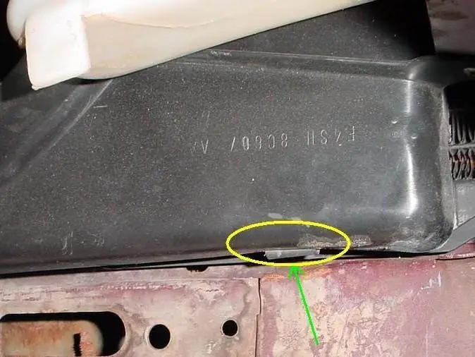

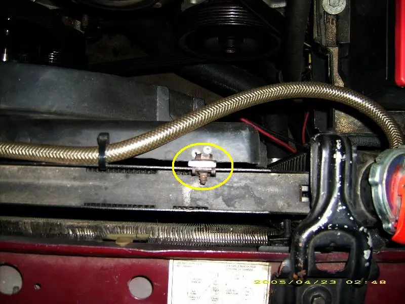

mine came off a T-bird, covers the entire radiator face and mounts exactly like the stock one after I cut holes in the bottom with a cutoff sheel for the clips and pop-riveted aluminum "L" brackets on the top.
