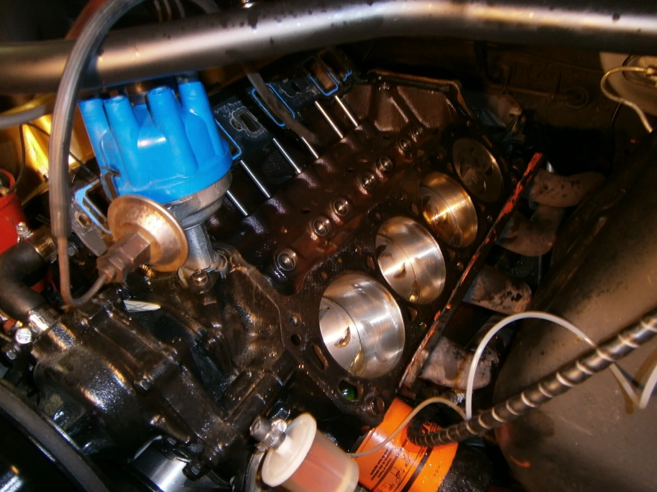

OK so I had my 289 machined and bored .040+ and crank ground -.010 and I rebuilt the engine myself w/ rebuilt GT40 heads. I used the correct bearing, etc.

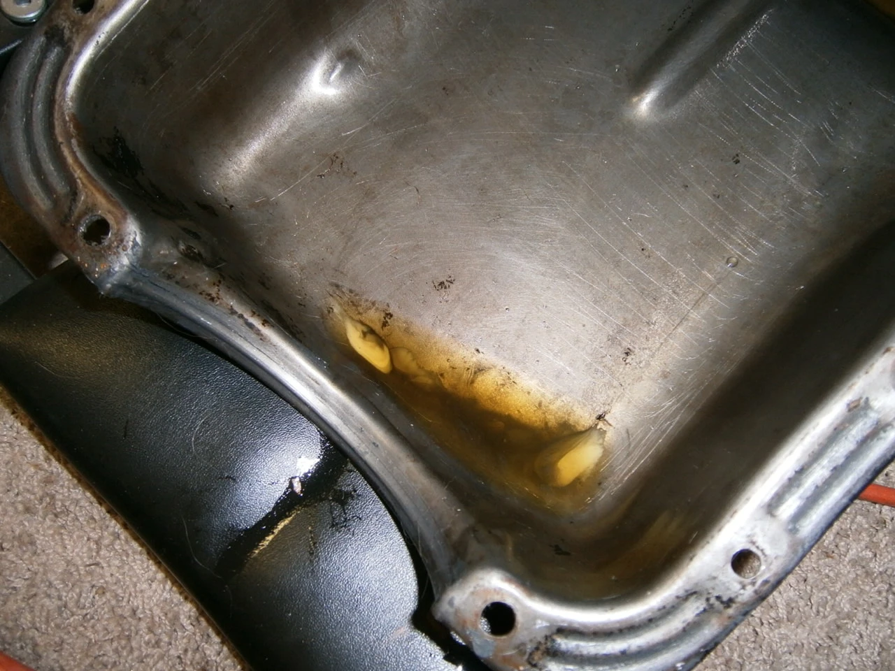

I noticed a knocking after the rebuild, which sounded a lot like a lifter knock, and I went all over the engine w/ a stethoscope and was not able to pin down the knock. I started reading and thought it was rod knock so I pulled the pan and all the rods are nice and tight but I noticed the oil was a little milky.
So, I started thinking maybe I have a blown head gasket? Maybe the GT40 head valves and my flat top pistons are hitting. Maybe I put a piston in backwards or maybe it’s just a bad lifter(s)?

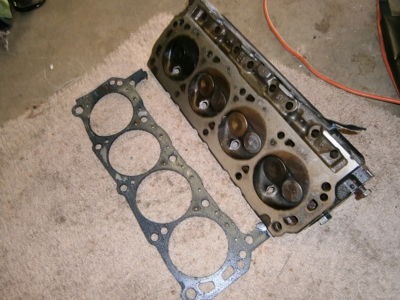

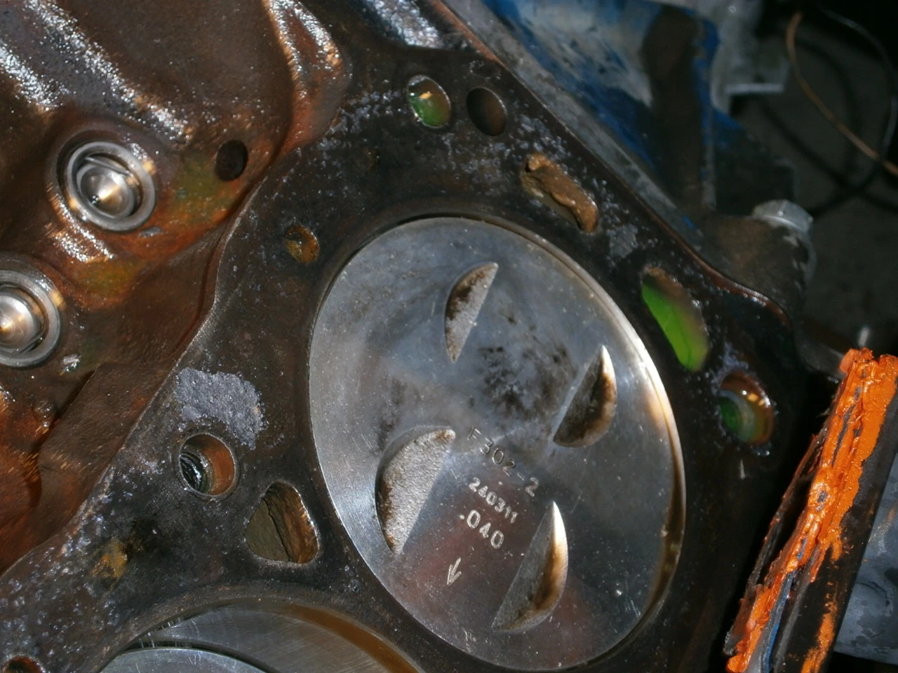

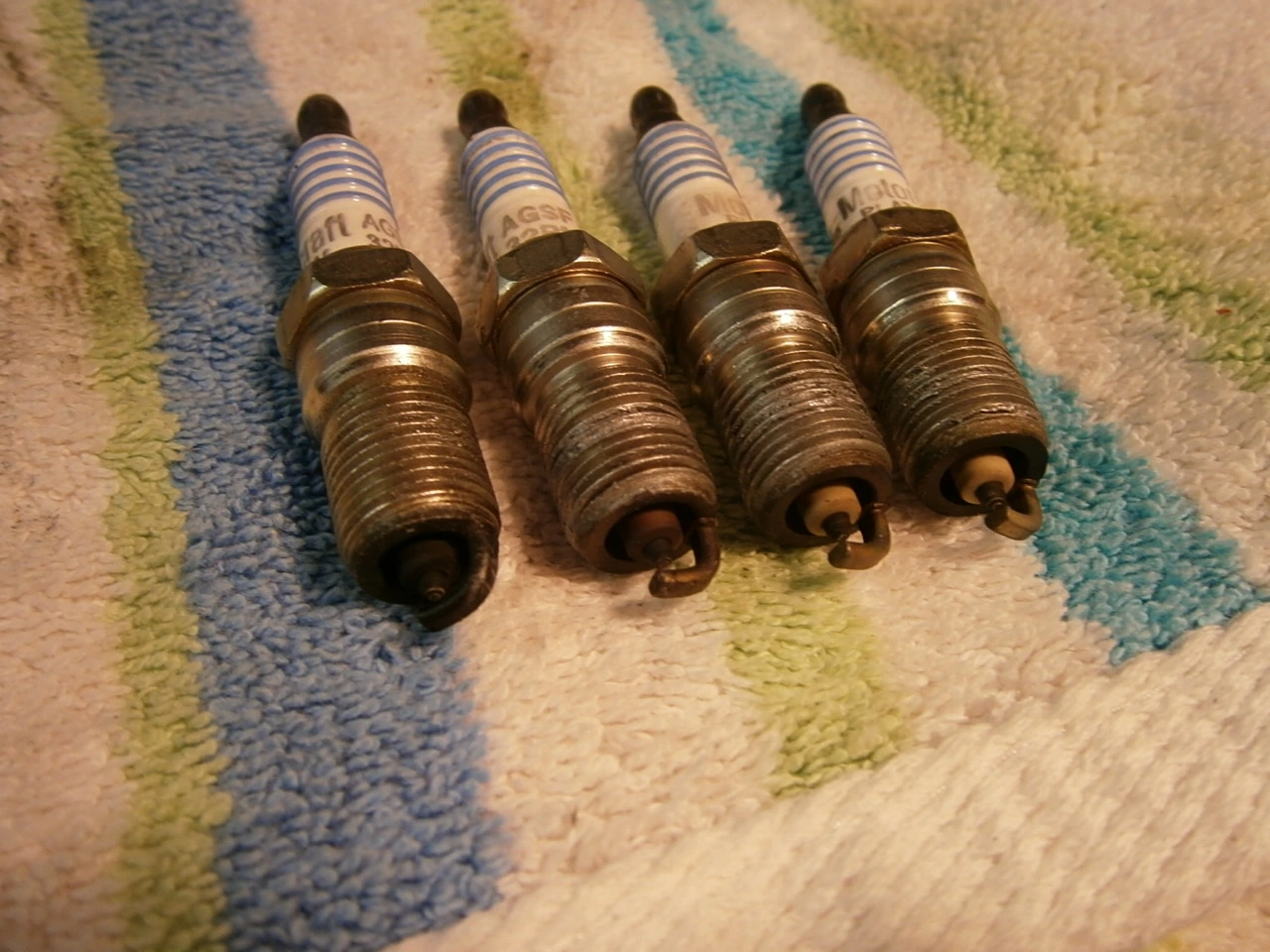

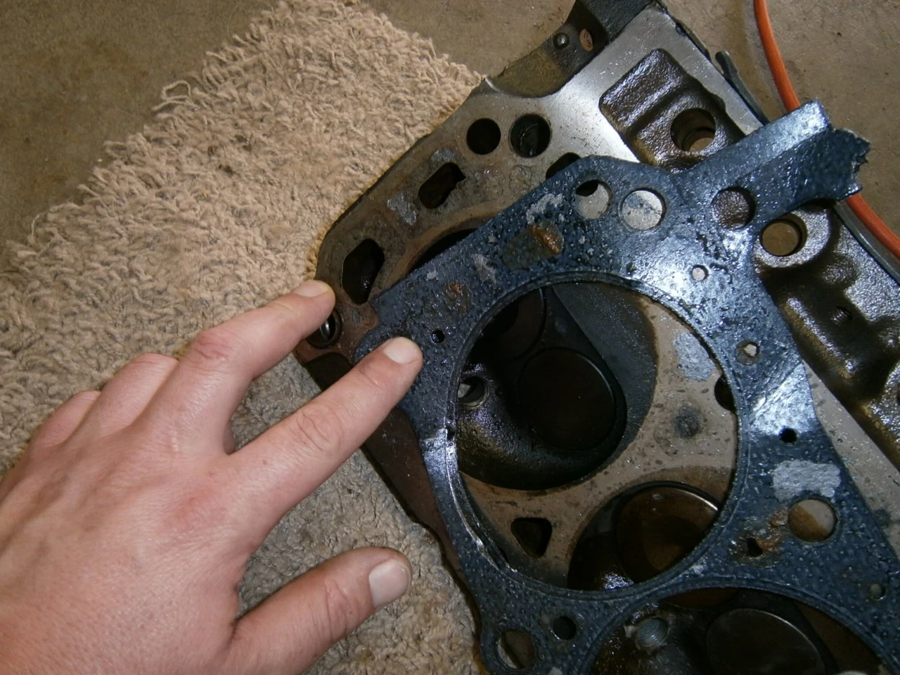

I pulled the intake and then the drivers side head (still need to pull passenger side head) and I found no evidence of the valves hitting the pistons or a backwards piston. I did discovered that the back cylinder was much darker than the other cylinders and the back plug was much darker. I then noticed the head gasket I used doesn't have holes for the back coolant passages (see pics)? Also in the photos all the cylinders look clean as I had to wipe down the cylinders because when I pulled the heads they filled w/ coolant, so I drained them, wiped dry and soaked w/ WD40.
So in my amateur opinion......I used the wrong head gasket which caused the back cylinder (s) to get too hot, blow the gasket(s) and start allowing a small amount of coolant in the oil which screwed up my lifters and created the knock.

Engine ran long enough for a break in for the new cam. which is a Summit knock off of a Performer cam. Ran about 30 minutes during break in, a couple dozen other times for timing and trying to find my knock and 1 trip around the neighborhood. Longest run was 30 minutes for the break in and the rest of the runs were about 10 minutes or less, so it never got hot enough during these runs.
I just pulled the other head and inspected all the cylinder walls and all look good. I pulled a few lifters and the cam lobes look good and little to no wear on the bottom of the lifters. Cam lobes are nice and sharp and look normal. I never had any signs of metal in my oil. I will take the heads to a machine shop this week to have magna fluxed to make sure I didn't crack them.
As for the knock I'm still leaning towards lifters......it sure sounded like lifter knock....

Lifters don't usually make a knocking sound, if anything, they make a tick. The heavier "knock" sound is usually referred to in a bottom end/ connection rod kind of way. Did you check your bearing clearances before assembly? Any idea why you have the one plug that was so much darker in color than the others? I had a similar, "unidentifiable" knock, that sounded like it was coming out of my carb. One of my rocker arms had been set wrong, and the noise was actually backfire through the intake. I readjusted the lifters, and then had backfire out of the exhaust, because I now had a wiped lobe on my cam.

I did check bearing clearance during assembly w/ Plastiguage and everything was in spec. The darker plugs were in the hot (overheating) cylinders....so I'm guessing heat darkened them. There were no signs of oil or water in the cylinders. I have always had good oil pressure cold and hot. I have pedestal mount roller rockers w/ correct lifter preload, I will double check the pre-load again during re-assembly.
I pulled the piston that got the hottest during break in, #4 and found no damage to the rod bearing, cylinder wall, piston or rings. My heads are now at a local machine shop that specializes in head work so they can inspect, once I get them back and no damage I plan to reassemble, fire it up and I will report back.
The "darker" coloration is the result of unburnt fuel building carbon deposits in the cyl. If it were burning hotter (too hot), it might be whiteish grey from ashy deposits. Rusty brown is the normal color deposited under normal burn.
Head gasket replacement completed and at start up and idle the engine still knocked. I ran it for about 30-40 minutes, at different RPM's in neutral w/ no load on the engine and after a while the knock seemed to disappear and reappear but mostly disappear especially at higher RPM (could have been hidden by engine noise) I can hear some noticeable lifter noise when I first rev the engine up from idle to a higher RMP (2-3K) and then it settles out while maintaining the RPM. I assume increased oil volume from higher RPM is quieting the lifters.
The engine is no longer overheating and temps from cylinder to cylinder seem to be in a reasonable range.
