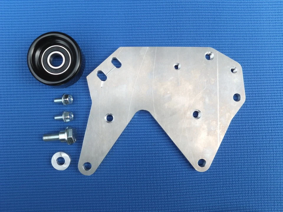

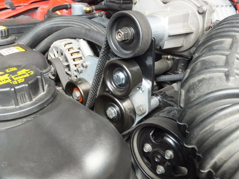

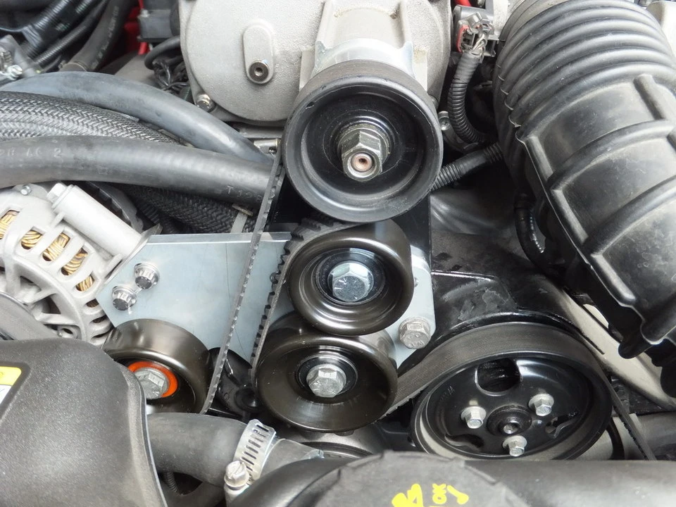

Redesigned the idler pulley bracket on my X-Charger SuperX TVS to run a third pulley for more belt wrap. No more belt slip! This will work on all X-Chargers, not just the TVS.
