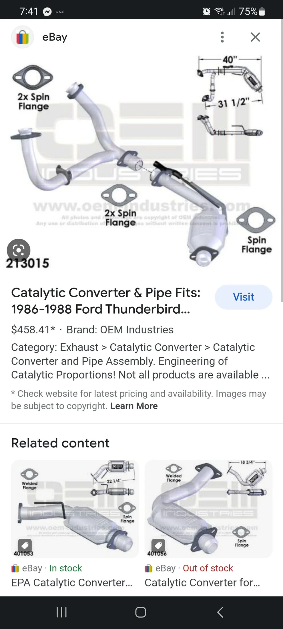

The 86- 88 thunder bird should be the same. They had the 3.8 in them and are on the fox platform.

Sickfox may B a lill closer as it's not as much a Y (as CJPprts) but more like the bird. oem industrie's 40 inch and 31.5 are great 'schmatics' 4 the bender, I C the 45*s, & hanger and O2 positions. It also looks like 1 cat not 2 (a Q I had) w/the longer for the wagon?
Gives me enuff idea to go there'n measure now for match up... hot digety! First progress (almost) since the drop off the lift w/a new paper transmish pump gasket (no leak, now 3 gears). The trim is very tough to find compaired to the bronk (course I was @ it 40 +yrs).
